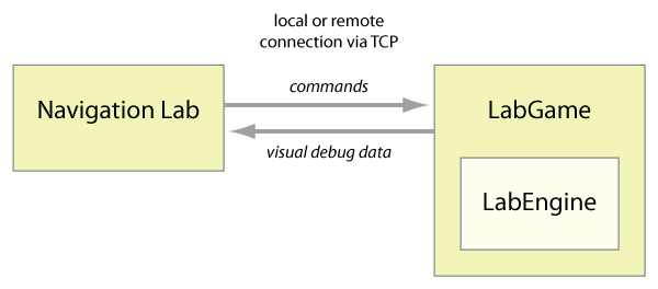

The LabGame
The LabGame is an executable that runs on all platforms supported by Gameware Navigation. It creates and runs an instance of the LabEngine internally, and adds a layer that
manages communications with the Navigation Lab.
It accepts commands from the Navigation Lab (e.g. to spawn bots and obstacles), and
passes those commands along to the LabGame. It also sets up a visual debug server,
and manages sending debug information from the LabEngine to the Navigation Lab.
