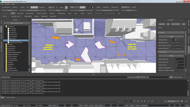

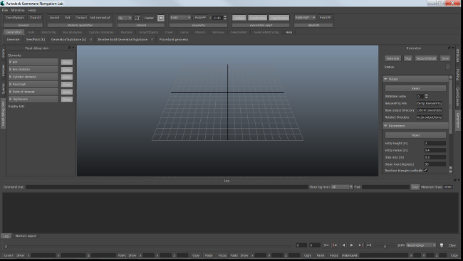

Open bin/win<platform>_<toolset>_release-md/NavigationLab.exe. You will see the main window of the Navigation Lab:

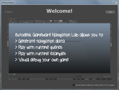

You should be presented with a series of drawings that present the main elements of the interface:
You can page through these drawings to get an overview of the controls related to the different workflows offered by the Navigation Lab. If at any point you need detailed information on any of the controls, see the tooltips in the interface.

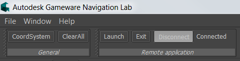

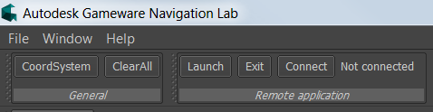

To launch and connect to the LabGame on your local host:
Alternatively, you can simply open a sample; if you are not connected to the LabGame when you start a sample, you will be asked if you want to launch and connect to the LabGame on your local host.
The LabGame runs on all platforms supported by Gameware Navigation. You can launch it on any other machine or console on your network, and connect the Navigation Lab via TCP.

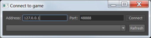

To launch and connect to the LabGame on a different host:
You will be prompted to provide some information about the host to which you want to connect.
If not, enter the IP address of the host in the Address field. Leave the default port number.

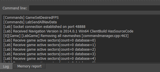

When you initiate a connection to a running game, the Disconnect button in the Remote application toolbox becomes highlighted. You can click this button at any time to disconnect or to stop retrying an unsuccessful connection attempt.
A successful connection is indicated in the Log window, and in the output printed by the LabGame to the console.

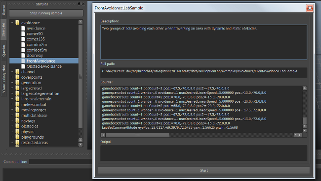

Once you have successfully connected to the LabGame, you can begin exploring the SDK samples supplied in the Navigation Lab. These samples are listed in the Samples panel, to the left of the main 3D view.
Open the avoidance folder, and click the FrontAvoidance entry.
The Navigation Lab opens a new window that shows you a description of the purpose of the sample, the location of the sample on disk, and the code of the sample.
Note that the code consists of a series of commands, such as labopenfile, gamespawnbot, gamespawnboxobstacle, gamebotsetroute, etc. When you launch the sample, commands prefixed by lab are carried out in the Navigation Lab, and commands prefixed by game are sent to the LabGame to be carried out in the game engine. You can also carry out commands yourself during the course of the sample. We'll look at different ways to do this later on.
Click the Start button to launch the sample. (If you are not already connected to the LabGame, you will be prompted to start it on your local computer.) When the sample loads, you should see an overhead view of a city street, with two groups of bots (yellow cylinders) walking from side to side. As they move, they alter their trajectories on the fly to avoid each other, the moving orange obstacles, and several static volumes tagged as non-walkable (areas with purple outlines that contain no NavMesh).

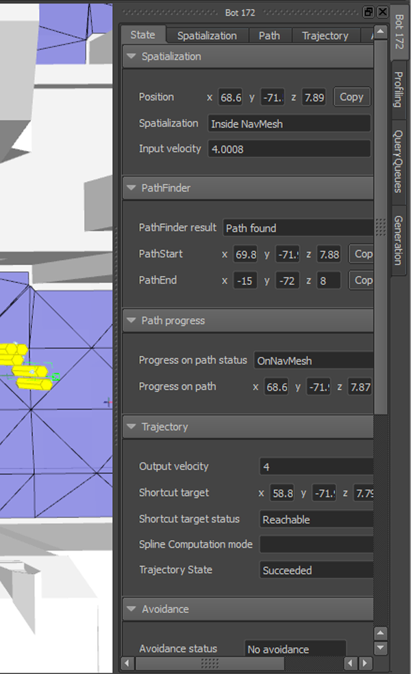

To view a list of properties for the selected object, open its panel on the right of the 3D view.
Additionally, you can control your selected object using the commands in the SelectedBot tab in the actions panel above the 3D view. This tab provides commands such as, for controlling where the Bot goes, what level of visual debugging information it sends to the Navigation Lab, removing the Bot completely from the game, and others. For instance, you can send a bot to a new destination by selecting Set target, or create a new set of waypoints for it to follow by selecting Set route.

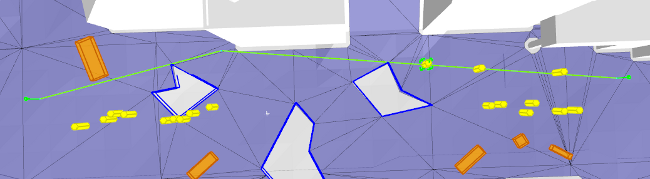

While you are connected to the LabGame, you can spawn new objects in the scene, such as bots, dynamic obstacles, TagVolumes, etc. To spawn an object, select the appropriate command from one of the tabs in the action panel.
For example, to spawn a new bot, choose the Bots > Bot command (or just press the b key). You will be asked to point your cursor anywhere in the NavMesh to choose a spawning point for your new Bot. Press the spacebar to complete the command. The Navigation Lab sends a command to the LabGame to create the Bot, which is visible in the Log window.
The LabGame creates the new Bot, sets it up to find and follow paths to a random destination (or, if you spawn a bot with a route, between the waypoints you provided). It then begins sending back the visual debugging data about that Bot to the Navigation Lab. You should see it appear in the 3D view and begin following the first segment of its path.

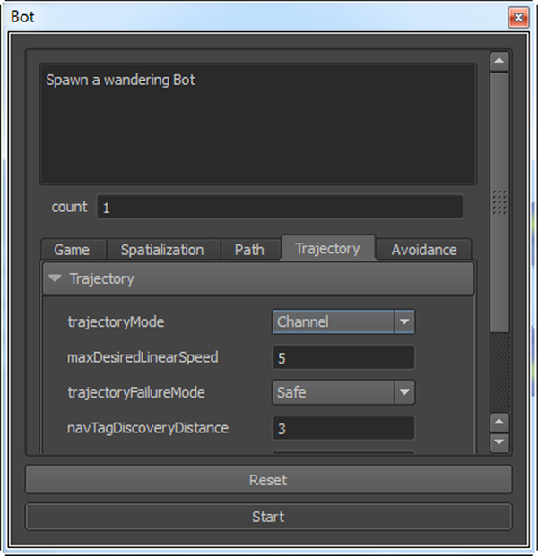

For example, you can configure new Bots to use the channel-based path following system
by default. On the Bots tab, click the
icon to the right of the Bot [b] action. In the Bot window, select the Trajectory tab, and set the trajectoryMode control to "Channel".
Any time you spawn a new Bot from now on, even after you close the window, the new Bot will automatically use these new settings. To revert back to the original settings, re-open the window and click the Reset button.

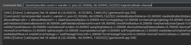

You can also paste commands directly into the Command line field at the top of the Log window. This allows you to customize all of the values sent by the commands, or to re-execute previous commands. Any parameters that you specify on the command line will override the default values for the action.

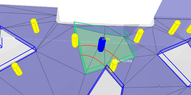

Smart objects are objects that can automatically take control of the way characters follow paths, in order to trigger custom movements or play custom animations.
Smart objects are typically specific to each game; they depend heavily on details about the gameplay scenario, and on technical considerations about the animation, physics and locomotion subsystems used in the game. The Gameware Navigation SDK does not contain any generic smart objects; it attempts to provide the tools for you to make your own smart objects as easily as possible.

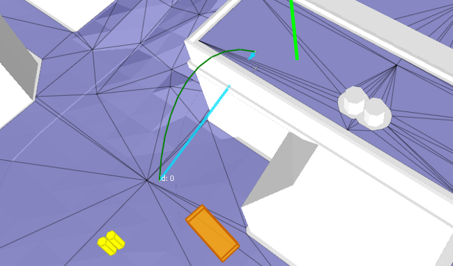

However, the LabEngine contains some sample smart objects that simulate common types of objects such as elevators, doors and jumping points. When you connect the Navigation Lab to the LabGame, you can spawn these smart objects at any time. For example, the following steps create smart objects that Bots can use to get up to the rooftops.

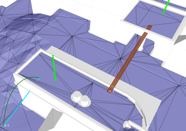

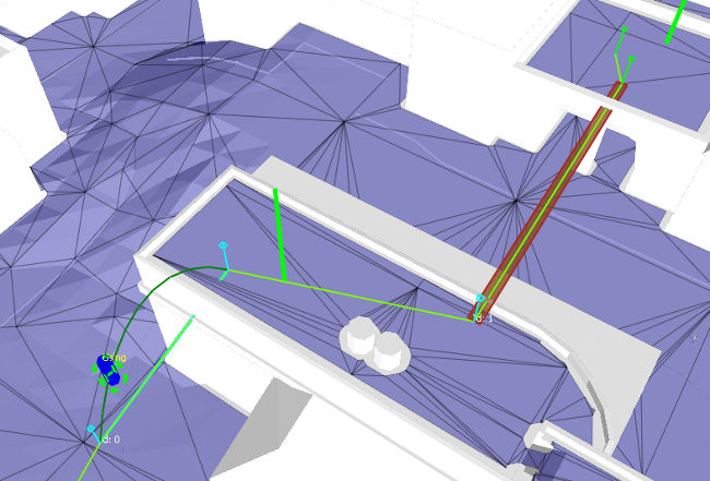

You should see a green arrow between the two points, which denotes an edge in a new NavGraph. For more information on NavGraphs, see NavData.
The new NavGraph is also automatically tagged with a custom data value that is associated with a smart object. You should see a green arc, which shows the trajectory that the smart object will make characters follow when they use the NavGraph in their paths.
You should see another new NavGraph edge connecting the two rooftops, with a purple rectangle to visualize the location of its associated smart object.
The Bot should plan a new path that includes the jump object and the plank. As it follows the path, it turns blue each time a smart object like the jump takes full control of its movements to make it follow a custom trajectory. Note that the Bot does not turn blue when traversing the plank: the plank does not take full control over the character's movements, it uses the default path following system to direct the character along the NavGraph to the other end of the plank.
