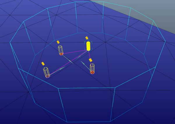

It is costly to compute the avoidance for a bot based on the entire world elements in a scene. Moreover, it does not serve the purpose because avoidance is mostly local and based on nearby entities.
It is also likely that the entities to avoid in a given frame are roughly the same in the subsequent frames because of time coherence. Therefore, you can leverage the NavMesh propagation structure to build a list of nearby potential colliders. You only need to update this list at a given frame rate. The following figure shows the collider collection extent displaying the entities that you can avoid.

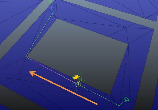

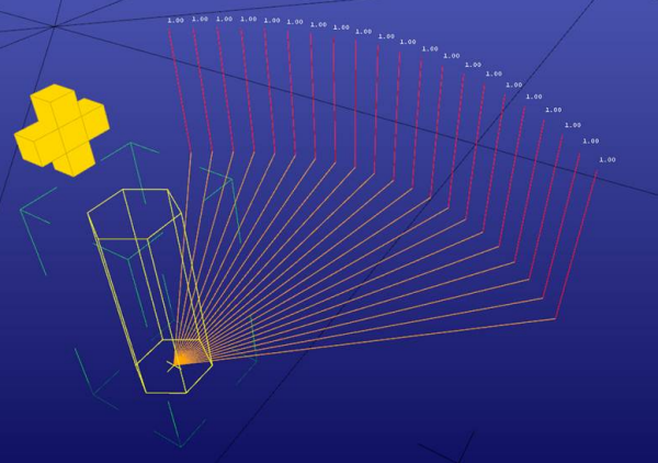

First, a global path following direction must be determined. This direction is computed to be compatible with the path following process.
Now, generate samples of N avoidance velocities around the path following direction. The following figure shows the generated velocity samples, all scored to 1.0 by default.
The speed of these velocities matches the desired speed in the bot config. You can configure the number and angle span for these velocity samples in AvoidanceConfig. Following are the parameters:

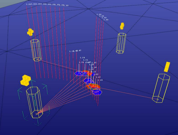

Collision Time
The avoidance is both local in space and in time. You can specify a time limit that serves as a horizon, and compute a collision time with the collected colliders for each sample. The following figure shows the collision time computed for a given frame.
If there are no collisions, or if the collision is beyond the configured time limit, you can set the sample cost as the time limit.

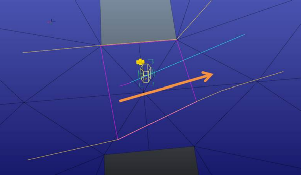

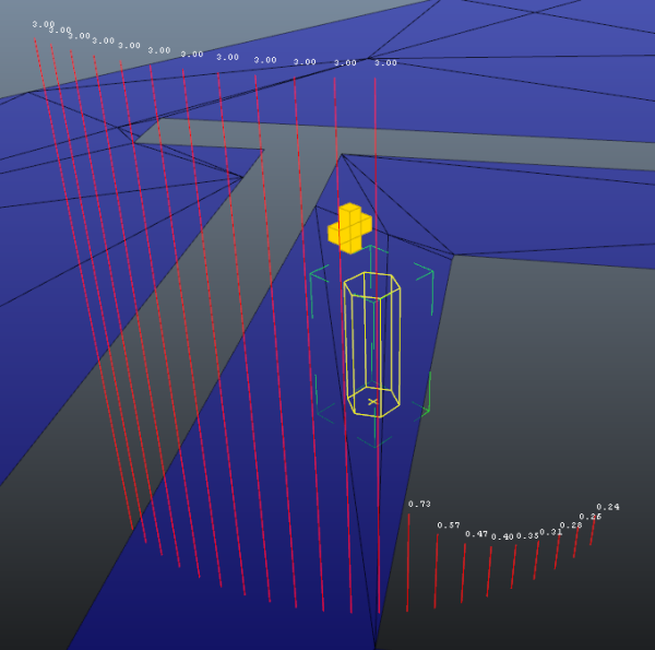

NavMesh/Channel Boundaries
You can score the samples based on their distance from the NavMesh/channel boundaries. The following figure shows that samples leading outside the NavMesh get a bad score.

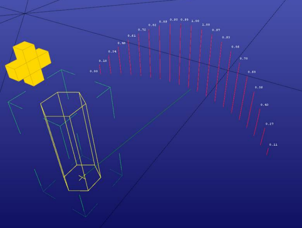

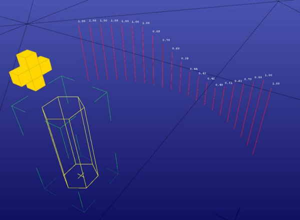

Time to Collision Ratio
You can divide the collision time with the horizon to compute a ratio between 0.0 and 1.0f, where 1.0f is the safest velocity. The following figure shows the collision time as a ratio.

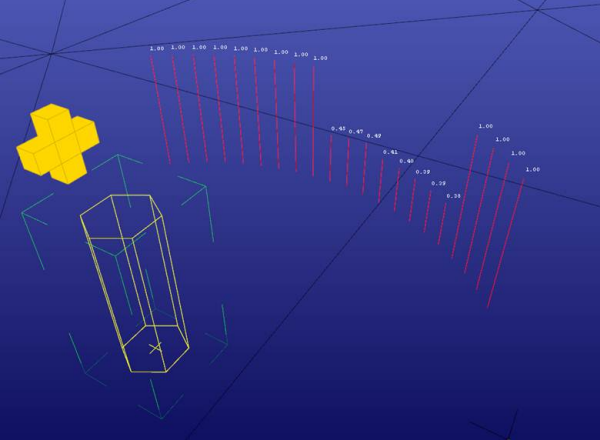

Smoothing

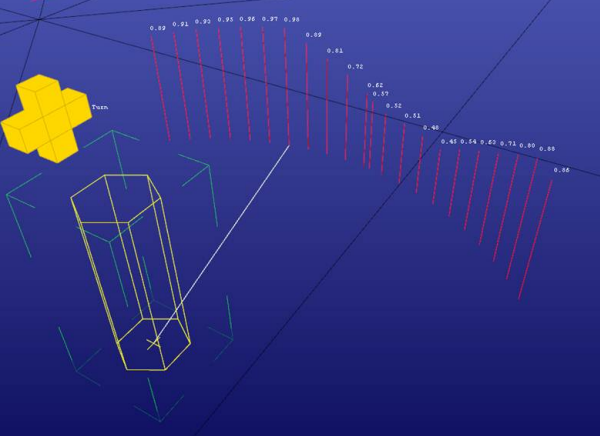

Sampling might be inaccurate because only a few degrees separate a valid sample from an invalid one. To avoid picking samples that are not safe, you can compute the average collision time ratio for each velocity sample with its neighbors. The following figure shows the smooth collision time.

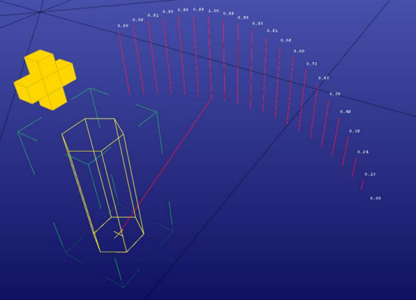

Final Score = (A * CollisionTimeRatio) + (B * DesiredVelocityDistance) + (C *  PreviousVelocityDistance)
Where, A, B, and C are constants that you can configure (best understood if A +B + C = 1.0). After you get the final score, simply return the velocity whose sample has the highest score. The following figure shows the chosen final score and final velocity to output for avoidance.
