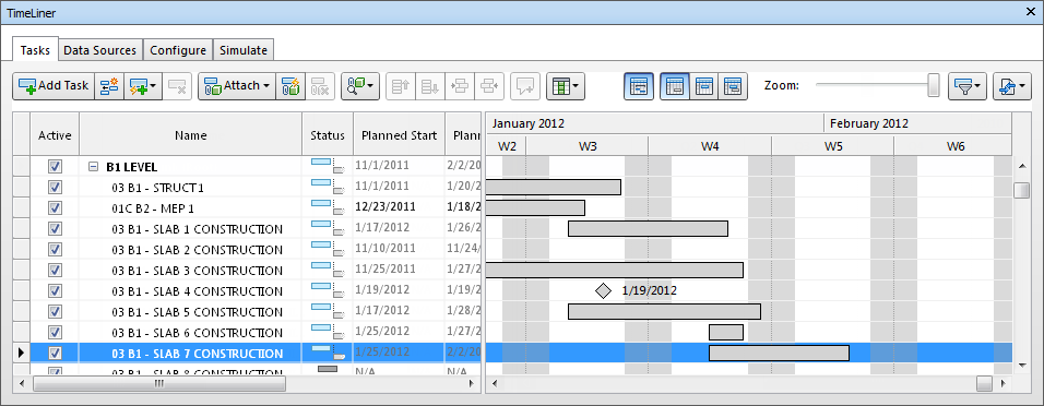

Tasks Tab
The Tasks tab enables you to create and manage project tasks. It shows all of the tasks in your schedule, listed in a table format. You can use the scroll bars at the right and at the bottom of the tab to move through the task records.
The Task View
The tasks are shown in a multi-column table, which provides some flexibility in how records are displayed. You can:
  • Move or resize columns
  • Sort column data in ascending or descending order
  • Add new user columns to the default column set
Tip: You can move between entries with the keyboard. Simply select a task, and use Tab and SHIFT + Tab keyboard keys to move forwards and backwards between fields. The keyboard can then be used to edit and set each entry where necessary.
The Task Hierarchy
Autodesk Navisworks TimeLiner supports a hierarchical task structure, as imported from a data source, for example Microsoft Project™ (see the Data Sources Tab for more information). The hierarchy can be expanded or contracted by clicking on the plus or minus sign, respectively, to the left of the task.
The Status Icons
Each task has its own status identified by an icon. Two separate bars are drawn for each task, showing planned against actual relationships. The color is used to differentiate the early (blue), on-time (green), late (red), and planned (gray) portions of the task. Dots mark the planned start and end dates.
Placing the mouse pointer over a Status icon shows a tooltip explaining the task status.

The Gantt Chart View
The Gantt Chart displays a colored bar chart illustrating your project status. Each task takes up one row. The horizontal axis represents the time span of the project, broken down into increments (such as days, weeks, months, and years) and the vertical axis represents the project tasks. Tasks can run sequentially, in parallel, or overlapping.
You can drag a task to different dates, or click and drag on either end of the task to extend or shorten its duration. Any changes are automatically updated in the Task view.
