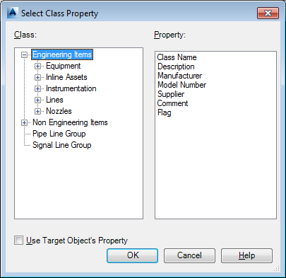

Select Class Property Dialog Box
Sets the class and property used to define the tag format
Class
Displays a list of classes to choose from for the tag format.
Property
Displays a list of properties, based on the class that is selected.
Use Target Object’s Property
Inherits the properties of the class you chose to start with.
