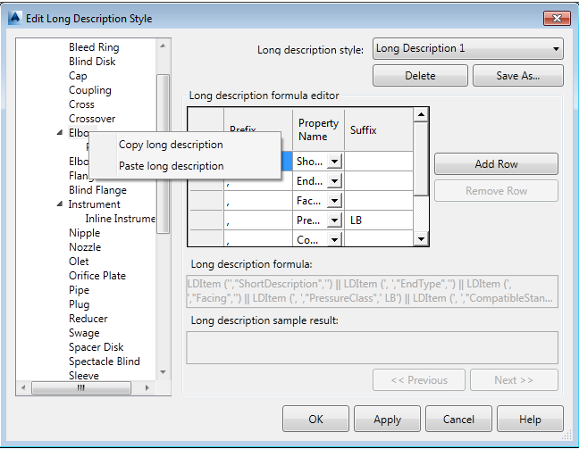

To set up a long description style
  1. In the Spec Editor, click Spec menu Layout and Settings.
  2. In the Spec Editor Layout and Settings dialog box, under Long Descriptions, click Edit Long Description Styles.
  3. In the Edit Long Description Styles dialog box, select the component for which you want to create a long description style.
  4. Click Add Row.
  5. In the Long description formula editor table, do the following:
    • (Optional) Under Prefix, type a prefix. For example, you can enter the project name or an underscore ( _ ).
    • Under Property, click a property from the drop-down list.
    • (Optional) Under Suffix, type a suffix. For example, you can enter a space followed by a dash and another space.
    • In the Long Description Formula box and the Long Description Sample Result box, review your description.
  6. In the Edit Long Description Styles dialog box, click Save As and save and name the description so that you can reuse it as needed.
    Note:
    Rather than start over with each component, you can copy the long description from one part to another or to many others. Right-click a component name to copy, then right-click another component name to paste the description.
  7. Click Apply or OK.
