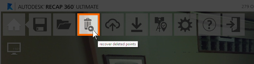

Recover Deleted Points

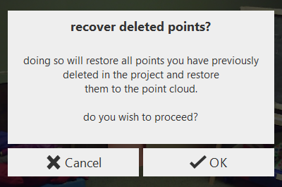

In addition to the standard "undo" action that can be used directly after performing a delete operation in a project you can also "recover" all deleted points. This is available from the Home flyout of the main menu.
Once confirmed, any points previously deleted are added back to the project.
Please note that this does not include points that have been removed through the "Shrink" optimization.
