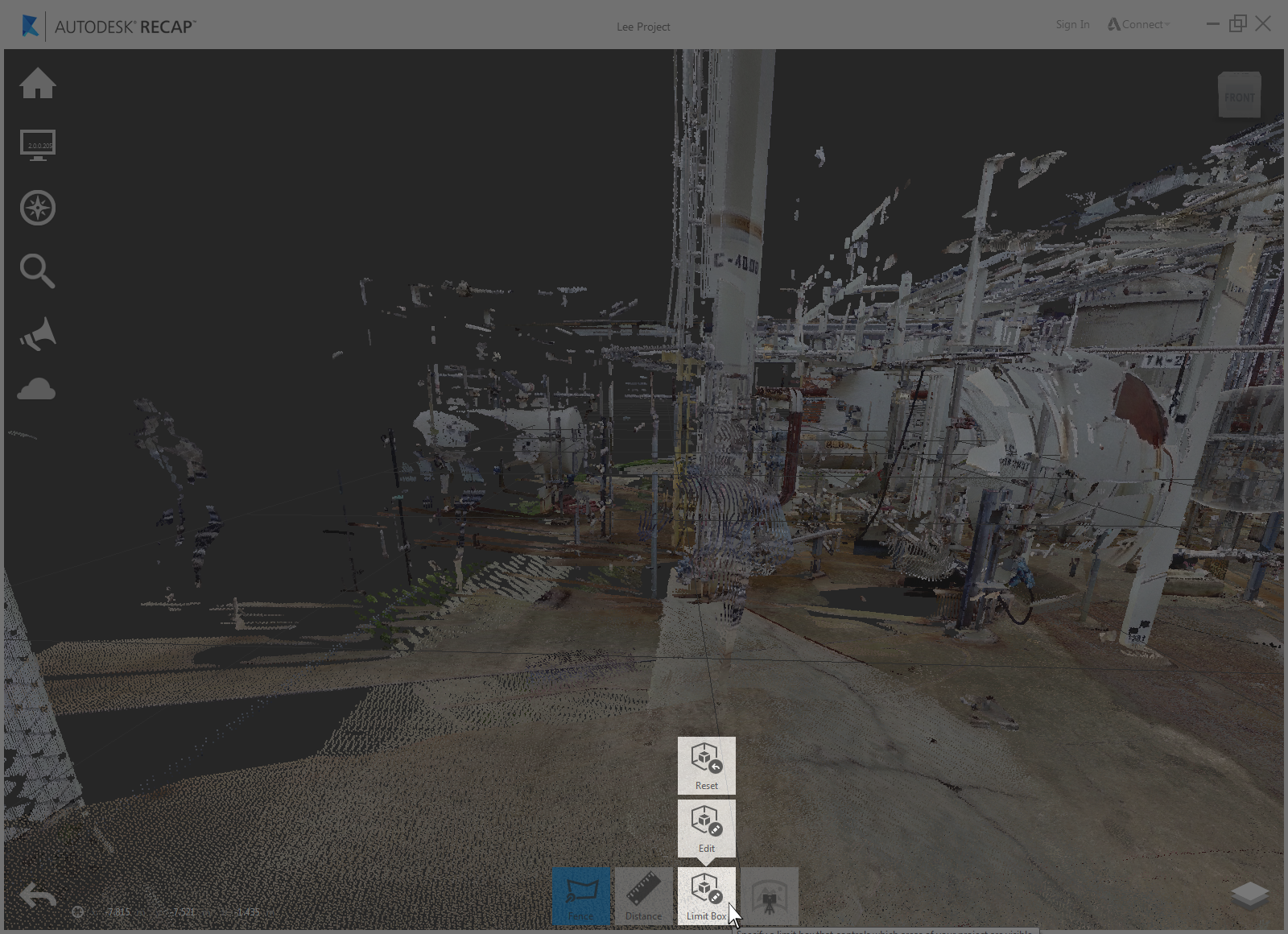

Every point cloud has a limit box which controls how much of the point cloud is displayed. By default, the limit box boundaries align with the outer extents of the point cloud.
You can adjust the boundaries and orientation of the limit box at any time. The limit box is especially useful when defining scan regions or clipping areas, because it can limit the width, length, and depth of the affected area.
Access the limit box tools through the button in the tool bar:
