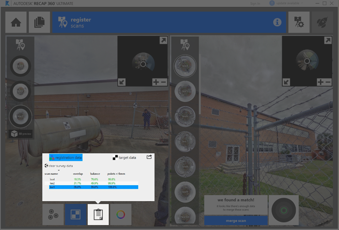

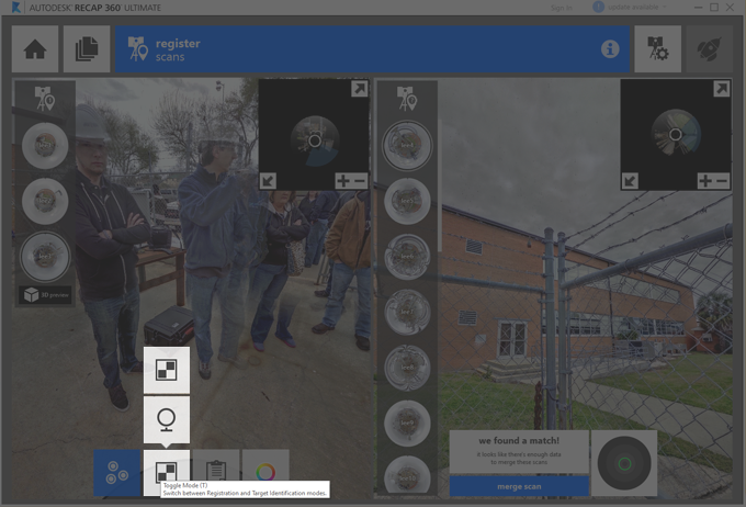

Targets for accuracy reporting can be placed with either checkerboard or sphere targets during or after the registration process. The tools are available from the main registration pane.

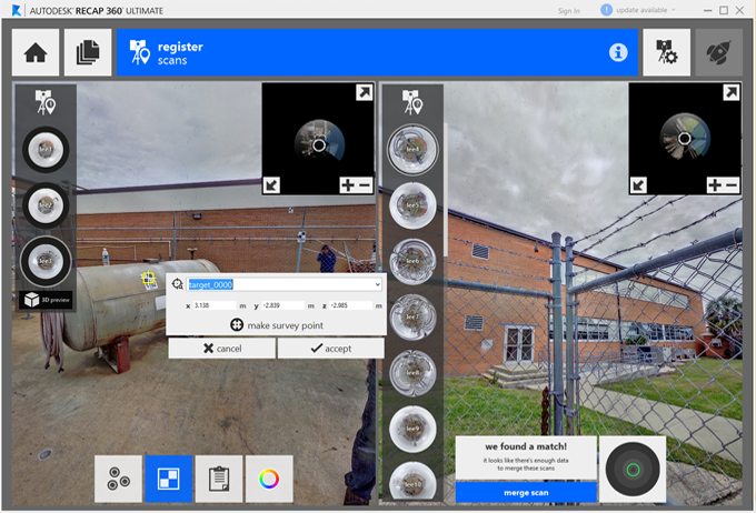

Targets can be named as you go. ReCap will automatically look for and center the target on click for precise measurement.
Once targets have been placed throughout results can be accessed through the reporting tool.
