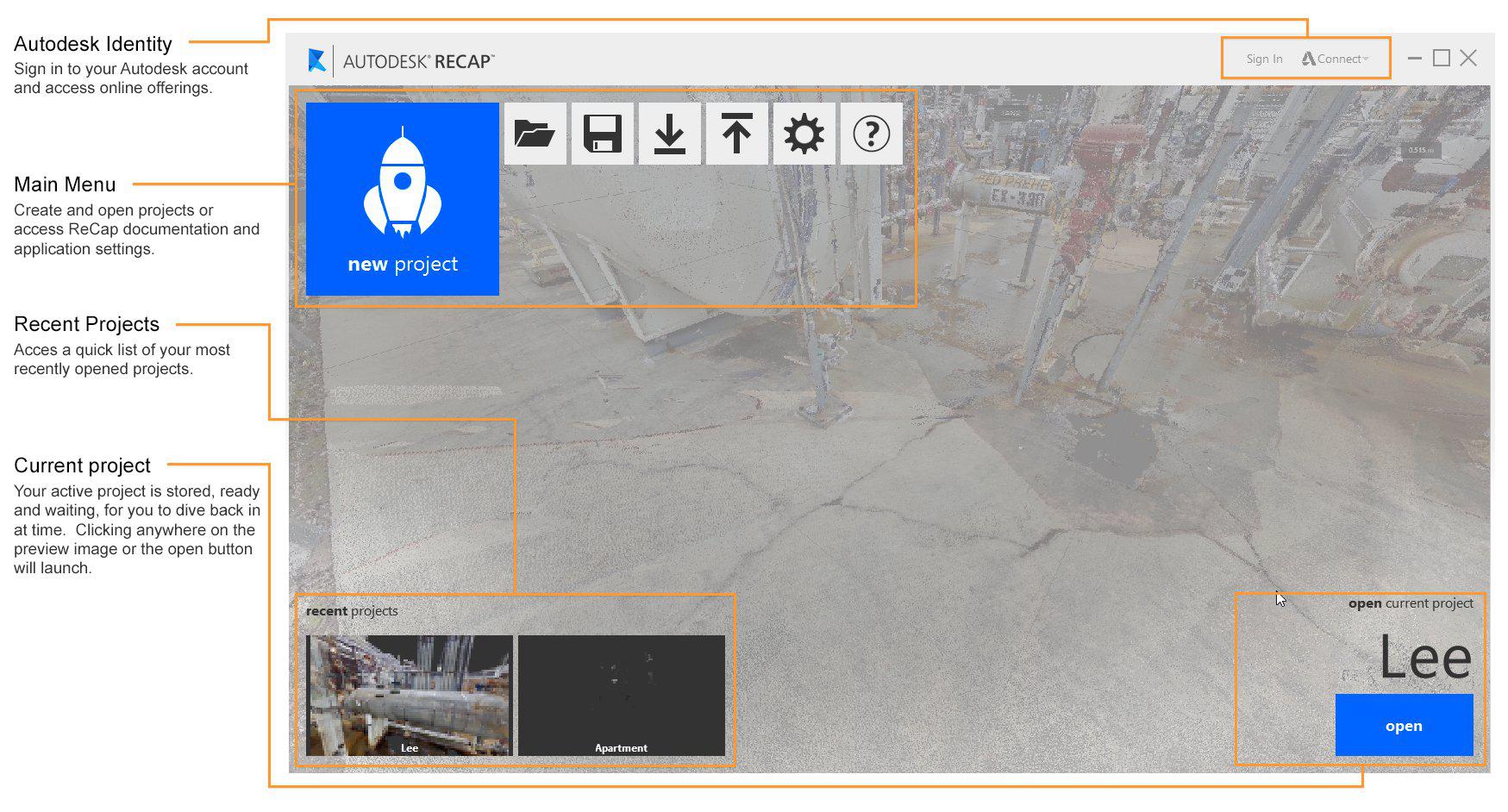

To get going with ReCap you’ll want to understand a little bit about the data you’ll be viewing and creating within the application. Autodesk ReCap lets you view and manipulate point cloud data from a number of sources. These include Project files which reference a large subset of indexed files, as well as unified scan documents that are stand-alone.
Let’s have a look at the initial screen to get a lay of the land and understand some of the UI that will kick you off in viewing and creating scan data.
