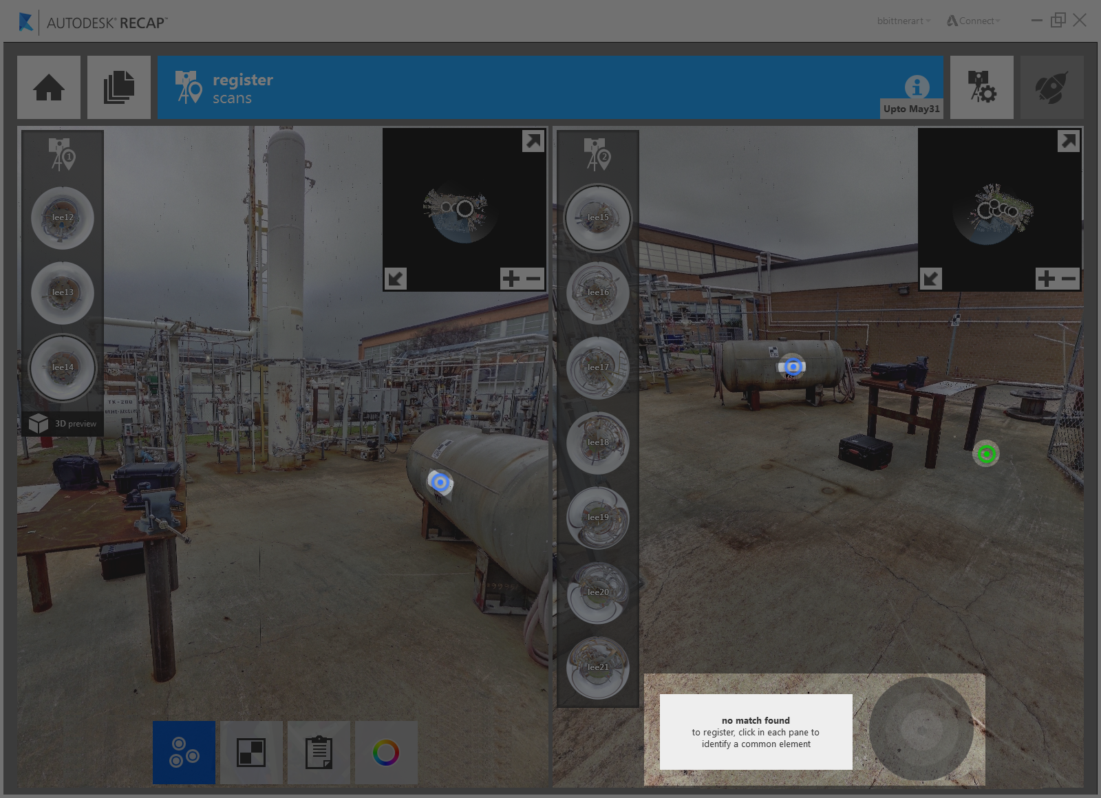

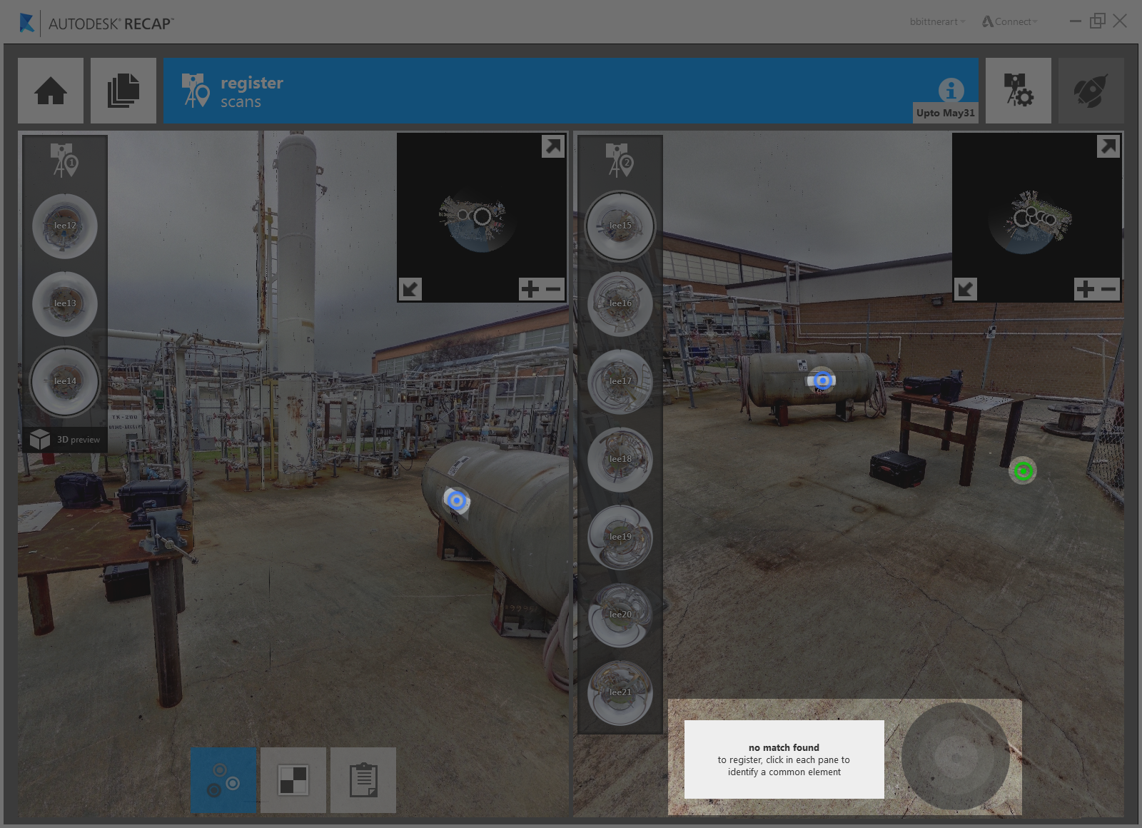

In some instances auto registration will not be able to find enough matching data to add a scan correctly. In these cases you will prompted to manually register the unregistered scans.

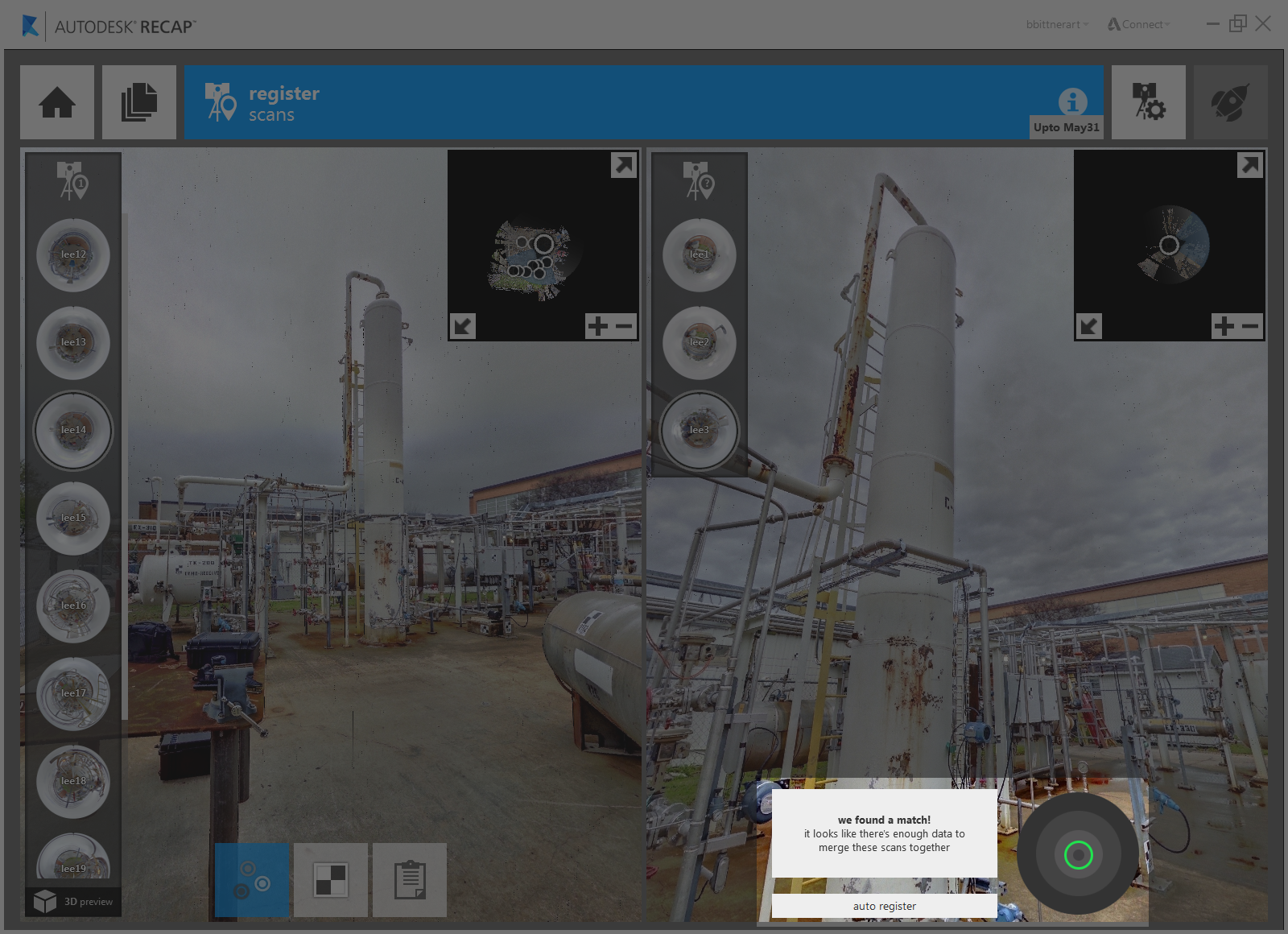

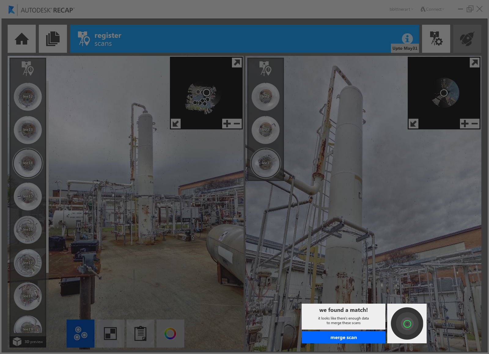

Auto registration is also active throughout the manual registration process. The active scan on the right is automatically checked for fit against the currently selected scan in the scan group on the left. In the case of a match or potential match you will be prompted to use the auto registration function.
Choosing different active scans on left and right will provide different levels of success for auto registration matching based on the match of the two currently visible scans, but the registration will be done on the entire scan group.
