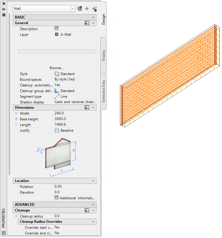

Wall in AutoCAD Architecture
The following properties of an AutoCAD Architecture wall are maintained when it is imported to Revit:

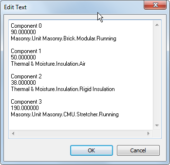

- Component Description: list of wall components, their materials and size
List of AutoCAD Architecture wall components, materials, and sizes in Revit
- Wall length
- Wall width
- Wall height
- AutoCAD Architecture style name
- Type name (Wall)

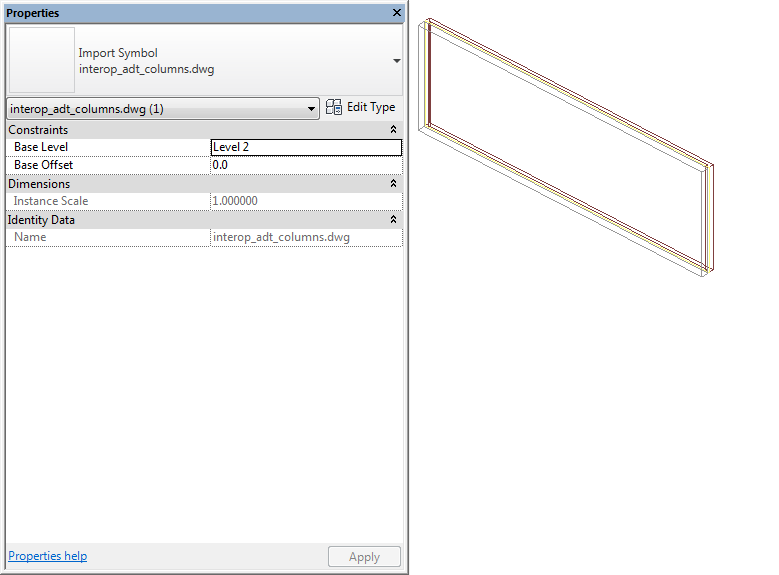

To import walls from AutoCAD Architecture
- Create or open the Revit project into which you want to import the AutoCAD Architecture walls.
- In the Project Browser, select the view in which you want the imported walls to display.
- Import the AutoCAD Architecture drawing into Revit, as described in Importing or Linking CAD Files.
When you import an DWG or DXF file into Revit, you can import all layers, all visible layers, or selected layers. After they are imported, layers can be selectively deleted from Revit at any time.
The imported drawing displays as a single import symbol.
- For more information about the imported objects, select the Import symbol, click Modify | <File Name> tab
Import Instance panel
(Query), and select wall blocks to query. A query displays the object type, block name (identical to imported drawing name), layer, and style name, as applicable.
To exit Query mode, press Esc.
