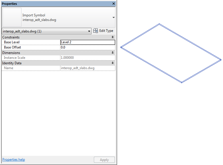

To import a slab from AutoCAD Architecture
- Create or open the Revit project into which you want to import the AutoCAD Architecture slab.
- In the Project Browser, select the view in which you want the imported slab to display.
- Import the AutoCAD Architecture drawing into Revit as described in Importing or Linking CAD Files.
When you import a DWG or DXF file into Revit, you can import all layers, all visible layers, or selected layers. After they are imported, layers can be selectively deleted from Revit at any time.
The imported drawing displays as a single import symbol.
- For more information about the imported objects, click Modify | <File Name> tab
Import Instance panel
(Query), and select slab blocks to query. A query displays the object type, block name (identical to imported drawing name), layer, and style name, as applicable.
To exit Query mode, press Esc.
