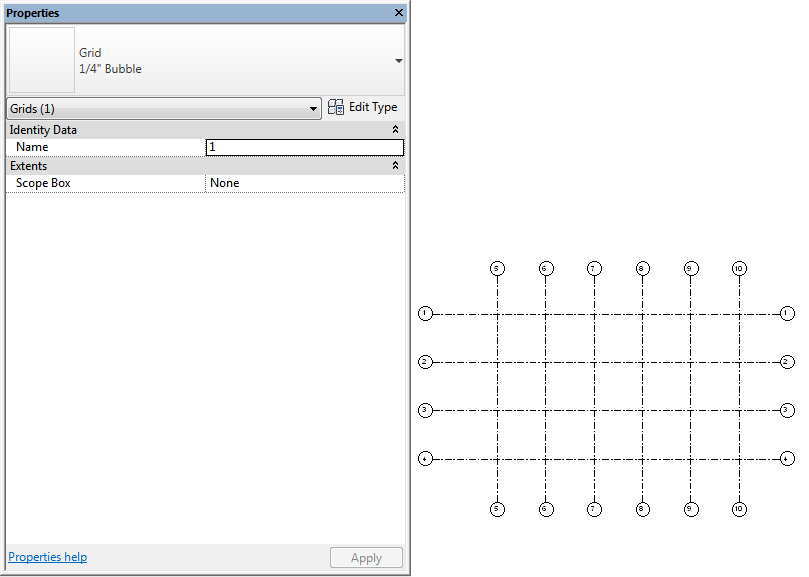

Export Grids
Revit grids can be exported to AutoCAD Architecture.

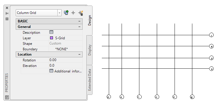

The AutoCAD Architecture grid is created in the plane of the lowest level of the Revit model that is not lower than the bottom of the view model outline. The multi-view blocks for the grid bubbles are anchored to the ends of the grid lines and will be created in the same plane.
The attribute text in each grid bubble is defined by the Revit grid name. The shape of the grid bubble is generated from the Revit grid head symbol. The scale of the generated grid bubble and text in AutoCAD Architecture is the scale of the current Revit 3D view.
Revit grid components are converted to AutoCAD Architecture grid components as follows:
Revit Component AutoCAD Architecture Component
grid lines custom grid object
grid bubbles multi-view blocks anchored to custom grid
grid bubble text attribute value in multi-view blocks
Note: The attribute value is editable in AutoCAD Architecture.

To export a Revit grid to AutoCAD Architecture
  1. Create a grid in Revit.
  2. Click ExportCAD Formats (DWG files).
  3. In the DWG Export dialog, under Select Export Setup, click (Modify Export Setup).

  11. To open the exported grid in AutoCAD Architecture, do the following:
    • Open AutoCAD Architecture.
    • Click OpenDrawing, and open the exported DWG file.
    If necessary, you can modify the grid in AutoCAD Architecture. For more information, search for “Grids” and “Multi-View Blocks” in the AutoCAD Architecture help.
