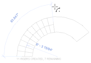

-  In the drawing area, click to specify the center point for the run.
-  Click to specify the start point.
-  Move the cursor clockwise or counter-clockwise to set the turn direction, and click to specify the endpoint and the total number or risers.

-  Create a Center-ends Spiral run as in the previous procedure, but specify the end point for the landing when the desired number of risers has been reached (less than the total).
- Click to snap to the center point of the first spiral run.
-  Move the cursor along the extension line, and click to specify the start point for the second run. Notice that the landing is created automatically. (The default landing depth is the same as the run width.)
- Click to specify the endpoint and create the remaining risers.
