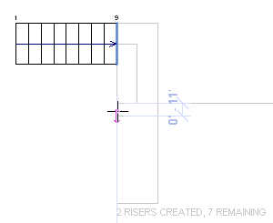

 As you draw, Revit LT indicates the run boundary and full steps required to reach the target level/elevation.
-  Move the cursor to draw the run, and click to specify the end of the run and the total number or risers.

- Click to start the first run.
- Click to position the landing when the desired number of risers has been reached.
-  Move the cursor along the extension line, and click to start drawing the remaining risers for the second run. Notice that the landing is created automatically. (The default landing depth is the same as the run width.)
- Click to finish the second run.
