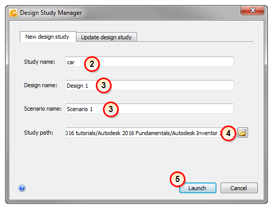

The Design Study Manager opens automatically when you launch Autodesk® CFD from CAD. It is highly versatile, and contains several functions:
  1. To check for issues in the geometry with the Model Assessment Toolkit, click the command to launch the Active Model Assessment Tool. After completing the assessment, the Design Study Manager opens. To launch directly into the Design Study Manager, click the CFD launch button or menu item.
  2. Specify a name for the Design Study in the Study name field. The default name is the name of the top level assembly or the part.
  3. Optionally, change the Design and Scenario names from the defaults.
  4. The default location of the study is the same path as the CAD model. To change this, click Set path..., and select (or create if necessary) the desired path.
  5. Click Launch. Autodesk® CFD starts, and the Design Study is created. The first Design and Scenario are listed in the Design Study Bar.

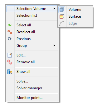

Selecting Objects
There are several ways to set the selection mode to volume, surface, or edge:
Selection Colors
Specific colors are used to indicate the selection status of entities:
  • When the mouse hovers over an entity, it turns green.
  • When an entity is selected, it turns red.
  • When the mouse hovers over a selected entity, it turns yellow.
When an item is selected, its label appears on the Selection List. To select entities from the Design Study Bar, simply left click on their label in the appropriate branch.
Note: To be selectable, an entity must not be occluded by another entity. If another entity blocks the line of sight to the desired entity, hide the blocking entity.
Selection Icons
Use the icons on the Selection panel to select and deselect multiple entities:
Select All entities of the current selection mode by clicking:
Deselect an item by highlighting in the selection list, and clicking:
Deselect all selected items by clicking:
Select the previously selected entities by clicking:
Note: Select All, Deselect All, and Previous are also available in the right-click menu.
