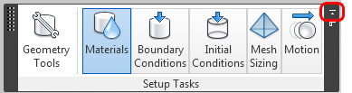

Drop-Down Menus
In the title bar of some panels, a small arrow indicates that additional controls are on a panel drop-down menu. To view these controls, click the arrow on the title bar of the panel:
By default, the menu disappears after the mouse if moved away. To lock the drop-down menu, click the pin icon:
To hide the drop-down menu, click the pin icon again.

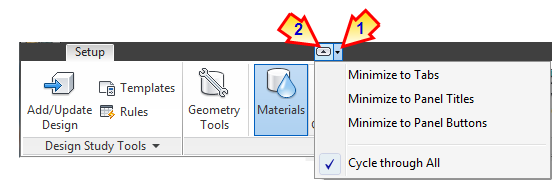

To minimize the ribbon
    There are three ribbon minimization modes: tabls, panel titles, and panle buttons.
  • To select the mode, click the menu arrow to the right of the tab labels (1), and select from the list.
  • To minimize the ribbon to the selected mode, click the arrow button (2). To restore the ribbon to the standard configuration, click the arrow button again.
  • Note: To use the arrow button to step through each mode, select Cycle through All.

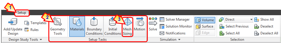

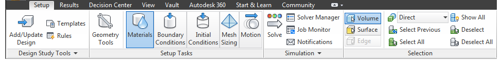

Setup
Use the Setup tab to define and run the simulation model:
  • Use Design Study Tools to update the Design Study and to manage Design Study Automation tools.
  • Select each of the Setup Tasks, from left to right, to define the simulation. (Note that each task, except Geometry Tools, spawns an additional context panel.)
  • Use Simulation to run and manage one or more simulations.
  • Control entity selection with Selection.
Note: The Setup Tasks and Simulation panels contain the primary controls for setting up and running a simulation.

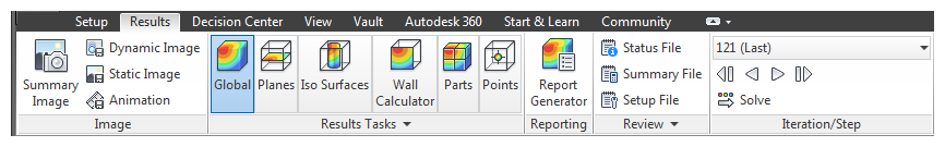

Results
Use the Results tab to visualize and extract results data:
  • Create and share images for design collaboration and design comparison using Image.
  • Select the active results tool from Results Tasks. (Note that each task spawns an additional context panel.)
  • Use Reporting commands to communicate your simulation results.
  • Use Review to extract information about the current scenario.
  • If the scenario has been continued multiple times or if intermediate iterations have been saved, select the iteration to view from Iteration/Step.
Note: The Results Tasks panel contains the primary tools for extracting and interpreting simulation results.

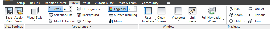

View
Use the View tab to control model appearance and to customize the User Interface:
  • Save a view and apply it to other models with View Settings.
  • Control the display of model with Appearance.
  • Configure the user interface and Graphics window with Windows.
  • Control the model-position, -orientation, and -zoom with Navigate.

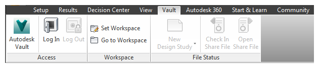

Vault
Use Vault to store and manage Autodesk® CFD data in the Autodesk Vault
  • Use Access to enter a Vault from Autodesk® CFD.
  • Use Workspace to manage and access the local folder where data is stored when checked out from Vault.
  • Use File Status to create and modify simulations using geometry stored in Vault. You can also check in and check out simulation files.

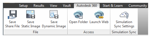

Autodesk 360
Use Autodesk 360 to sync Autodesk® CFD results images and setup files to your Autodesk 360 Documents folder.
  • Use the File commands to manually sync data to your Autodesk 360 account.
  • Use the Access commands to manage your local cache and Autodesk 360 folders.
  • Use Simulation Sync to configure how your simulation data is automatically uploaded to Autodesk 360.

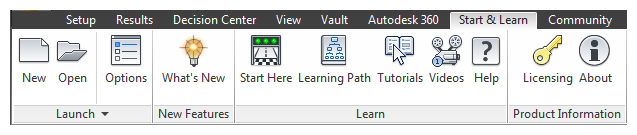

Start & Learn
Use the Start & Learn tab to create or open a design study and to explore Help Resources:
  • Create or open a design study with Launch. (This is an alternative to launching from CAD.) Additionally, access Design Study Automation tools before opening a design study and prescribe user interface settings.
  • Learn about new functionality with New Features.
  • Explore Help and Learning resources with Learn.
  • View product and licensing information with Product Information. Note: The Product Information panel only appears in the Desktop version of Autodesk® CFD, not in Autodesk® CFD Flex.

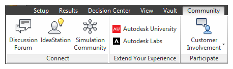

Community
Use the Community tab to Interact with other Autodesk® CFD users:
  • Connect with other Autodesk® CFD users. You can share knowledge, collaborate with other users, and share your ideas for enhancement requests.
  • Extend Your Experience to stay connected with the latest technology and innovation to come from Autodesk.
  • Participate in the Customer Involvement Program to influence the direction of Autodesk® CFD.

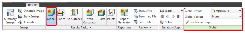

3. Context Panels

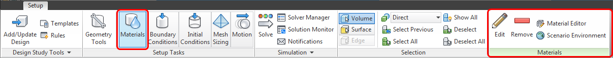

The controls in Setup > Setup Tasks and Results > Results Tasks invoke specific task modes that are the fundamental steps in the Autodesk® CFD process. Several commonly-used controls related to the active task are placed in an additional context-sensitive panel on the right side of the ribbon.
For example, when the Materials task is active on the Setup tab, the Materials context panel appears:
When the Global task is active on the Results tab, the Global context panel appears:

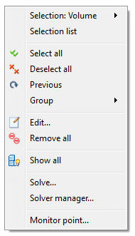

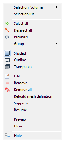

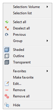

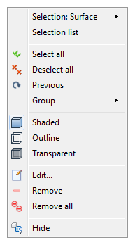

5. Right-Click Menus
The right-click menus contain commonly used controls that are contextual to the current task. They provide convenient access to commands while allowing focus to be maintained directly on the model.
Setup Tasks
On every Setup task, use the right-click menus to change the selection type, select and deselect items, and open the appropriate Quick edit dialog. Additionally, access commands specific to the current task.
Right click off model
Right click on part (Materials task)
Right click on part (Boundary Conditions task)
Right click on part (Mesh task)

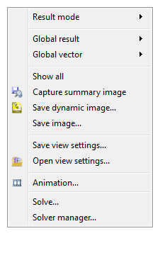

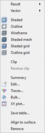

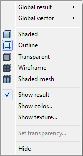

Results Tasks
On every Results task, use the right-click menus to modify the appearance of the model, part, or results object.
Right click off Model
Right click on Part
Right click on Plane or Iso Surface (while either Planes or Iso Surfaces task is active)
Note: If unsure where a command is located, right click on the object to open the menu.

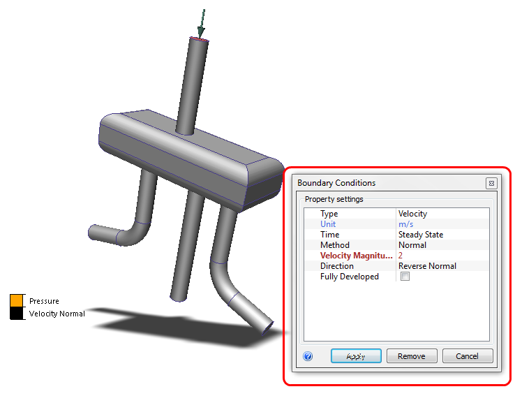

6. Quick Edit Dialogs
The quick edit dialog is the primary tool for specifying parameters and values for model set up and result extraction. Every task has a unique quick edit dialog that contains fields for task-specific settings. They are an essential workflow element of Autodesk® CFD.
They are several ways to open quick edit dialogs:

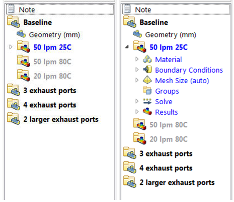

10. Design Study Bar: Manage all aspects of the Design Study with the Design Study bar
The Design Study Bar is a fully interactive tree-based tool for defining and managing all aspects of the Autodesk® CFD process. The Design Study Bar follows a hierarchical structure that organizes the Autodesk® CFD process into three fundamental levels: Design Study, Design, and Scenario.
Each design study contains at least one design (specific CAD geometry) and each design contains at least one Scenario (collection of materials, boundary conditions, and mesh settings, along with the associated analysis results). Designs are listed in bold black letters and scenarios are shown in bold blue letters. The setup assignments and results are listed in thin blue letters within each scenario. Manage the analyses from this window.
Optionally, click here to learn more about each branch of the Design Study Bar...

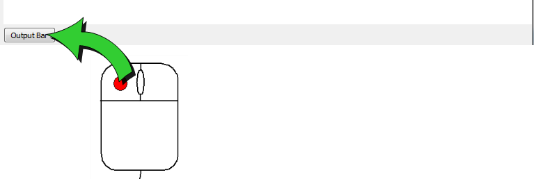

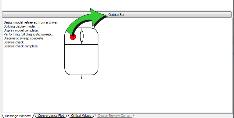

12. Output Bar: View analysis status information and important results data
Collapse the Output Bar as needed:
To expand the Output bar:

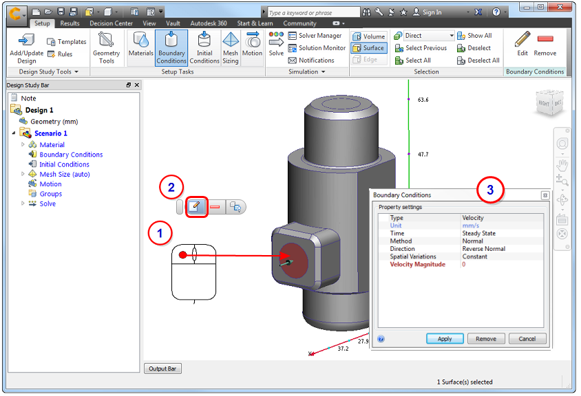

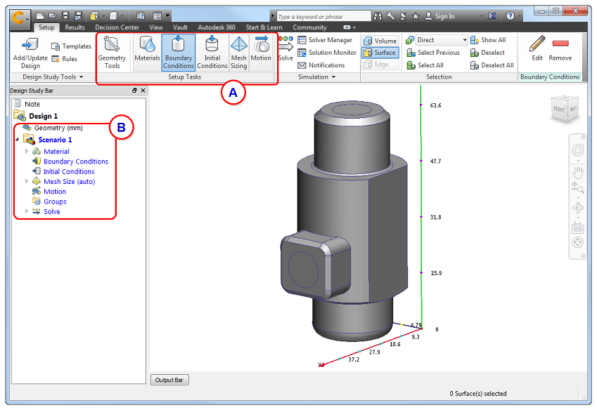

Model setup workflow
The Setup tasks all follow a similar workflow. There are several ways to work with the model. You should use the method that is most comfortable.

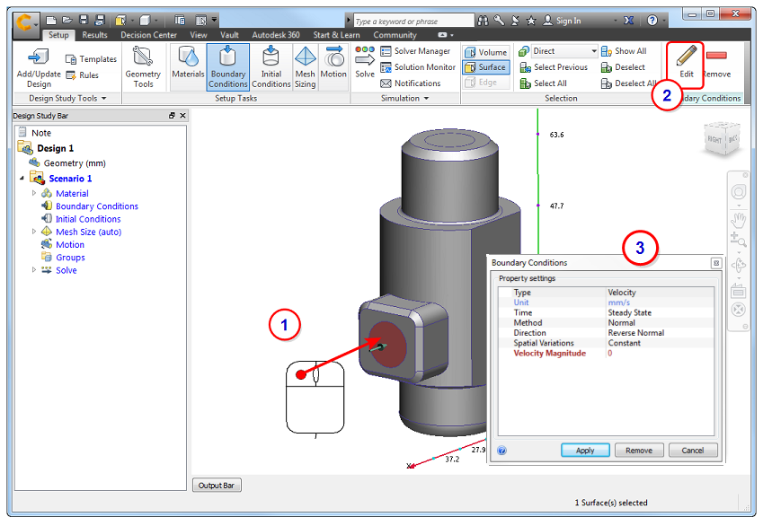

To begin, select the task from either the Setup tab (A) or from the Design Study bar (B):
To select and define settings with the Ribbon:
  1. Left click on the model entity (surface or part).
  2. Click Edit on the context panel.
  3. Specify settings in the quick edit dialog.
To select and define close to the model:
  2. Click the Edit button on the context toolbar.

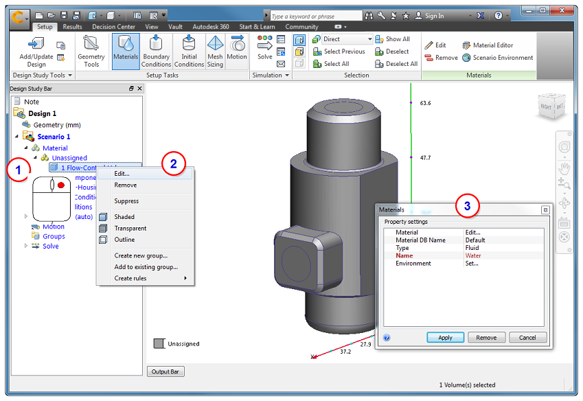

To select and modify from the Design Study bar:
  1. Right click on the model entity or existing setting in the Design Study bar.
  2. Click Edit...

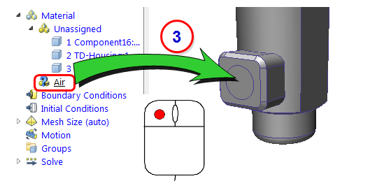

To define and assign:
  1. Open the quick edit dialog. (Left click and select Edit on the context toolbar.) Alternatively, right click on Material or Boundary Condition in the Design Study bar, and click New material... or New BC..., respectively.
  2. Specify the settings in the quick edit dialog, and click Apply.
  3. Drag the unassigned setting from the Design Study bar onto the model entity.
Note: To apply a setting that is currently assigned to another entity, drag it from the Design Study bar onto the target entity.
