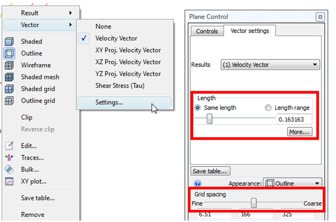

7. Right click on the plane, and click Vector, and Settings. Modify the vector length and spacing on the Vector settings tab of the Plane control dialog.

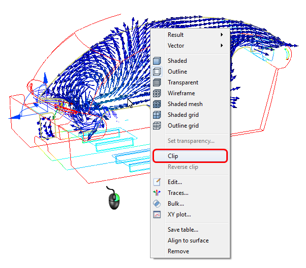

10. Right click on the results plane and select Clip.
11. Select Shaded from the Quick Access toolbar:
You should see this view. If you see the other side of the model, rotate it so you can see the results plane, right click on the plane, and click Reverse Clip.
Note: Clipping improves visibility of specific model regions, and is a powerful way to display vectors when the model is shaded.

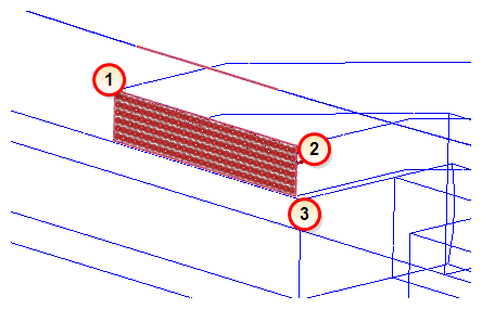

18. In the Traces dialog, select Rectangular grid as the Seeding method. Set Rows to 30 and Columns to 6. Click Add points.
19. Click the upper left corner of the inlet (1), click the upper right corner (2), and click the lower right corner (3):
20. Click Add trace set.

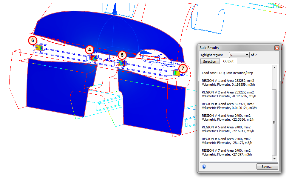

26. Drag the normal axis of the cut plane triad to position the plane through the four front registers as shown:

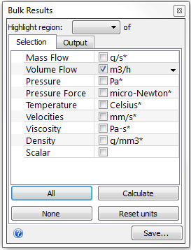

27. Compare the flow balance between the four registers: Select Bulk from the Planes context panel. Select Volume Flow. Click on the adjacent units field, and select m3/h.
28. Click Calculate.

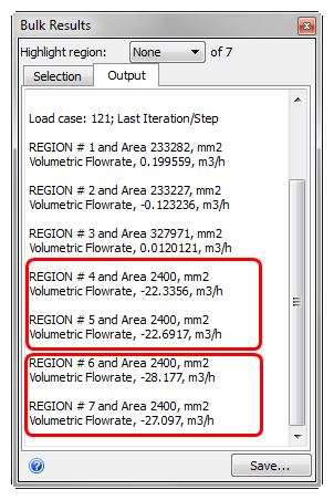

29. Select regions from the Highlight region menu to identify the distinct registers.
Note: This results plane is divided into 7 distinct regions. Autodesk® CFD numbers these regions. To highlight the corresponding region on the plane, select the corresponding number from the Highlight region menu. In the image, the regions are 4, 5, 6, and 7, but these numbers may differ for your model.
30. Observe the flow rates from all four registers. Note that the two interior registers (regions 2 and 3) each provide roughly 20 m3/h of air while the exterior registers (regions 6 and 7) each provide close to 30 m3/h.
