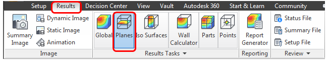

1. Select Planes from the Results tab:

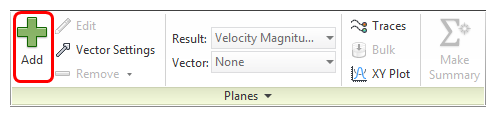

2. Create a Plane by clicking Add:

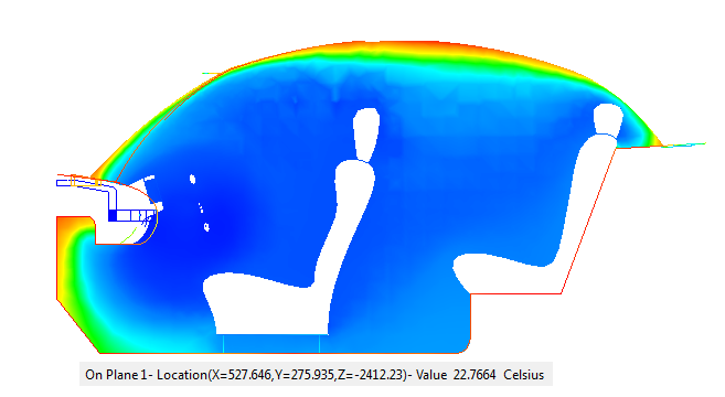

9. To measure temperatures of the front and rear occupants, position the plane normal to the x axis and through the front and rear seats. Left click on the results plane and click X on the toolbar. Drag the plane so it aligns with the outside flat surface of the headrests of both front and rear seats, as shown:
10. To align the view normal to the plane, click the Right face of the View Cube.
To measure the temperatures on the plane:
11. Probe by hovering the mouse pointer over the plane. Check the temperature values in the Status Bar at the lower left of the interface. Probe near the feet, knees, hips, and heads of both front and rear occupants.
Note: If you have clicked outside the Autodesk® CFD interface, you should click anywhere within model display window to ensure probing is active.

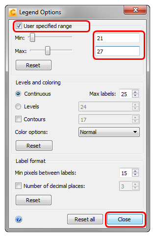

12. Highlight the temperature differences in this area by adjusting the legend range:

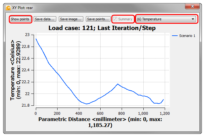

18. To plot the temperatures experienced by the rear occupant, open the XY Plot dialog (if it is not already open). Assign the title “rear” to the XY Plot.
19. To select plot points, click Add Points on the XY Plot dialog, and click on the results plane near the feet, knees, hips, and head of the rear occupant:
20. Click Plot on the XY Plot dialog
21. Click Show Points to hide the point symbols. Check the Summary box. Close the plot dialog after inspecting the results.
Note: The feet of the rear occupant are approximately 3° C warmer than the head of the occupant, and the hips and knees are also warmer than the head. This is information we will use to evaluate this model so we save it to the Decision Center by checking the Summary box.
