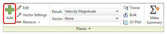

To create a Plane
- On-model: Right click on or near the model (not on an existing Plane). Click Add plane.
- Off-model: Click Add in the Planes context panel:

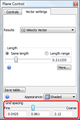

To control the vector density
- Drag the Grid spacing slider on the Vector Settings dialog.
- To specify a finer or coarser grid spacing beyond the slider range, key in the values in the field adjacent to the slider.

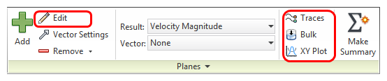

Plane Functionality
Planes provide a wide array of visualization functionality:
Accessing Plane Functionality
Note: Ensure Planes is selected on the Results Tasks panel.
- On-model Method 1: Left click on the Plane, and click the context toolbar icon.
a. Settings (Controls)
b. Traces
c. Bulk
d. XY Plot
- On-model Method 2: Right click on the Plane, and select from the menu.
- Off-model: Click the icon in the Planes context panel.

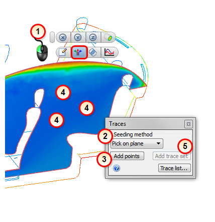

To create a set of Particle Traces
- Create a results plane, and open the Trace dialog.
- Select a Seeding method.
- Click Add points.
- Click points on the Plane (or drag the grid).
- Click Add trace set.
Pick on plane
To select seed point locations, left click on the Results Plane.

To adjust the Grid spacing density:
- Enable vectors on the results plane.
- On the Vector settings tab of the Plane Control dialog, drag the Grid spacing slider.

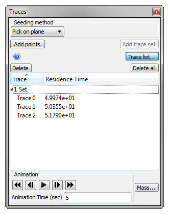

Residence Time
The time that a trace takes to traverse through the model is its residence time, and is listed for each trace. Residence time can vary based on the flow, the geometry, and if the particle has mass.
A trace with a relatively longer residence time than the rest will affect animation. Such a trace will animate very slowly followed by a very rapid animation of the others.

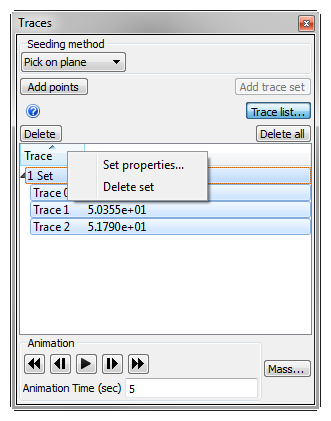

To view, sort, and modify traces
- To view the trace list, click the Trace list... button.
- To sort traces, click the column headers.
- To modify trace appearance, right click on Set, and select Set properties....

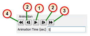

Animation
- Begin the animation by clicking the Play button. While animating, this button changes to a Pause button.
- To "grow" traces either forward or backward, click one of the incremental Step buttons.
- To display the traces at their longest, click the Fast Forward button.
- To display the traces at their shortest, click the Rewind button.

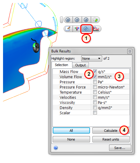

The Bulk Calculator quickly calculates and shows bulk-weighted results on a Results Plane. Bulk (mass-weighted) results are automatically updated as the active Plane is moved.
Workflow
Start by positioning the Results Plane in the desired location.
- Open the Bulk dialog.
- Select the desired quantities for bulk calculation.
- Change the units of the output quantity with the adjacent menu list.
- Click the Calculate button.
- The bulk results are written to the Output tab.
To save bulk data when animating a transient analysis, click the Save button. The results from the active time steps will be saved to an Excel csv file.
