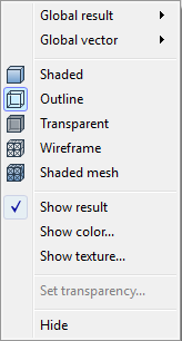

Controlling part appearance is very important when viewing results. Autodesk® CFD provides tools to control how parts appear to allow you to create images and views that best convey the behavior of the design. These commands are available by right-clicking on the model while visualizing Results or by right clicking on the part names in the Results > Material branch of the Design Study bar.
Shaded, Outline, Transparent, Wireframe, Shaded mesh
Show result

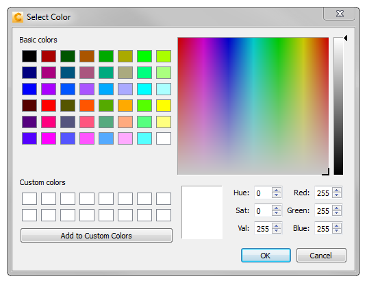

Show Color…
Show Texture…
