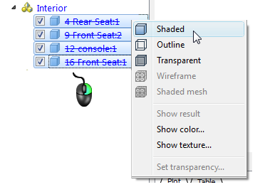

2. Display the interior components:
3. Display the interior components as shaded:

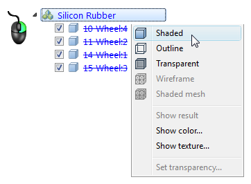

4. Display the tires as shaded:
5. Right click on the Silicon Rubber branch and select Show color…
6. Select Black from the palette and select OK.
