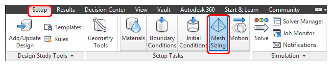

1. Click Mesh Sizing on the Setup tab:

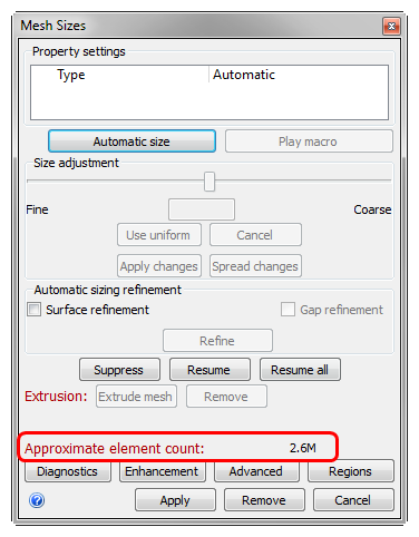

8. To determine if the mesh needs to be modified, check the Approximate Element Count. Right click off the model, and click Edit... Note the element count.
Note: The number you see may be slightly different, depending on slight variations in the model due to the originating CAD system.
Note: Recall that approximately 2 GB of RAM are required for every million elements.

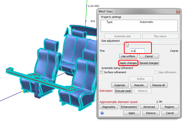

9. Observe the mesh distribution in the model. Notice that the mesh is too coarse in the duct and too fine on the seats.
Note: The mesh preview shows one node across the thickness of the duct. Better results are achieved with 3 to 4 nodes across important passages so we will refine the mesh here. By contrast, the seats contain a finer mesh distribution. Because the mesh distribution on the interior surfaces do not heavily influence the mesh in the flow regions, coarsening the mesh here will reduce analysis resources and time.
10. Select the two volumes of air in the ducts. In the Mesh Sizes dialog, drag the Size adjustment slider to approximately 0.6. Click Apply changes.

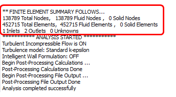

16. Scroll up in the Output Bar to note the final Element Count.
