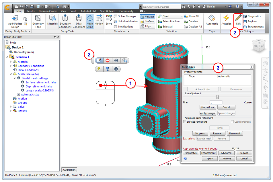

Use the Mesh Tools to customize the mesh distribution. All tools are accessible from the Mesh Sizes quick edit dialog. To simplify the workflow, many are also available on the context tool bar and on the context panel.
Context tool bar
Left click on or near the model:
  1. Open the Mesh Sizes quick edit dialog.
  2. Invoke automatic mesh sizing.
  3. Create mesh refinement regions. (To focus the mesh in critical locations.)
  4. Check the model with Diagnostics. (To remove potentially problematic features.)
  5. Suppress a selected part. (To remove less important parts, and decrease the analysis time.)
  6. Resume a selected part.

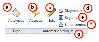

Context panel in the Ribbon
  1. Toggle between Automatic mesh sizing and Manual mesh sizing.
  3. Open the Mesh Sizes quick edit dialog.
  5. Create mesh refinement regions. (To focus the mesh in critical locations.)
  6. Modify or disable Mesh Enhancement .
  7. (In the expansion panel of the context panel.) Customize the mesh distribution by modifying Advanced meshing controls.
On-model mesh modification
In some cases, the mesh distribution needs to be modified:
  1. Select the part.
  2. Open the Mesh Sizes quick edit dialog.
  3. Make the appropriate refinements or invoke Automatic Refinement.
