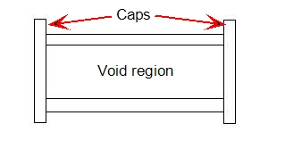

- The Granite mechanism handles automatic void filling better in many cases. It is more tolerant of caps that extend past the internal void:
