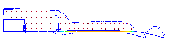

Rectangular grid
Draw a rectangle on the active Plane by clicking three locations: the top two corners and a lower corner:
Specify the number of grid points in the Width and Height fields.

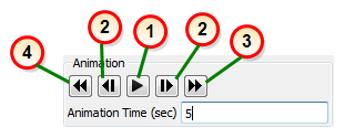

Animation
- Begin the animation by clicking the Play button. While animating, this button changes to a Pause button.
- To "grow" traces either forward or backward, click one of the incremental Step buttons.
- To display the traces at their longest, click the Fast Forward button.
- To display the traces at their shortest, click the Rewind button.
Vary the animation speed with the Animation Time setting.
