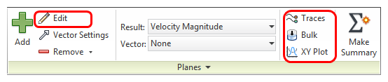

To interact with Planes, click Results (tab) > Results Tasks (panel) > Planes.
Plane Functionality
Planes provide a wide array of visualization functionality:
Accessing Plane Functionality
Note: Ensure Planes is selected on the Results Tasks panel.
- On-model Method 1: Left click on the Plane, and click the context toolbar icon.
a. Settings (Controls)
b. Traces
c. Bulk
d. XY Plot
- On-model Method 2: Right click on the Plane, and select from the menu.
- Off-model: Click the icon in the Planes context panel.

- Right click on the plane, and click Summary.
- Click Make Summary on the Planes context panel.
