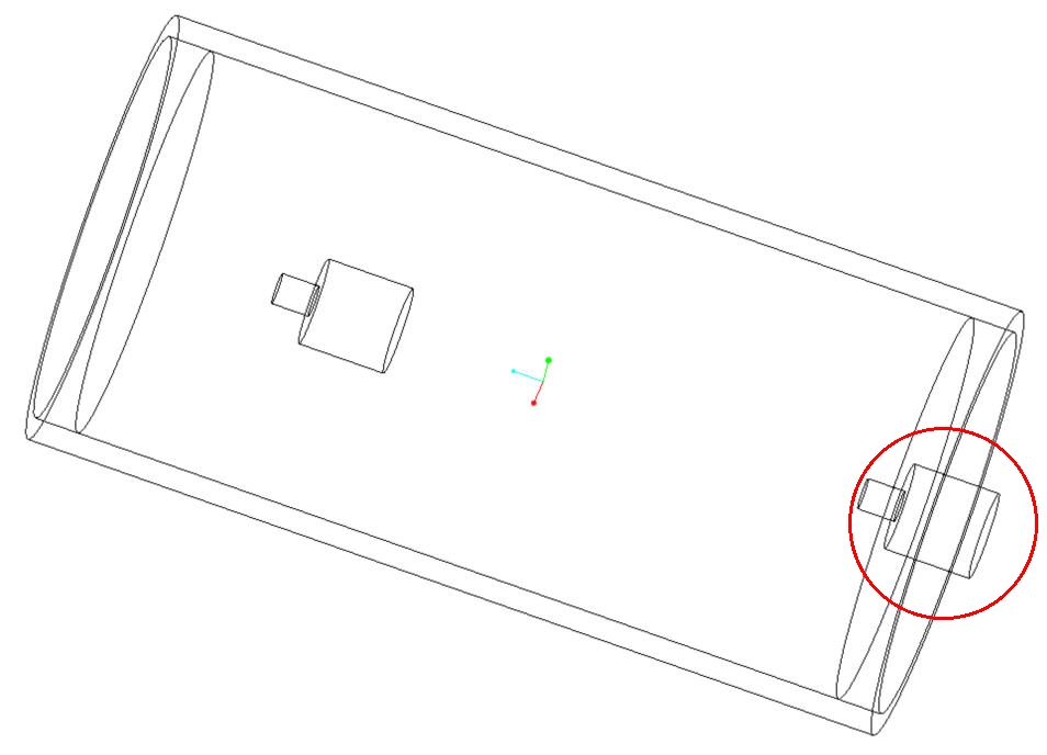

  1. Parts that are inside of the void must not protrude through the outer wall of the geometry. If this occurs, the void filling will fail. This is shown:

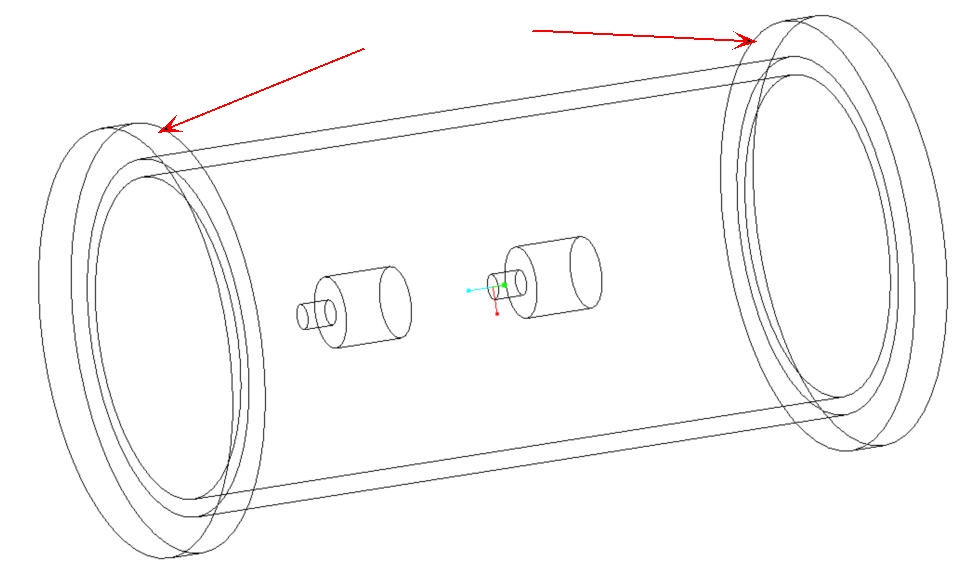

  2. When using the Mechanica launch method, end caps must not extend beyond the geometry surrounding an opening. In this pipe example, the cap must not extend beyond the outer diameter of the pipe. An example that will fail is shown:
