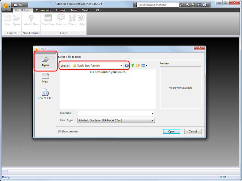

  1. Start Simulation Mechanical. On the Open dialog box, click the Open icon in the left column, and navigate to the folder containing the pin joint assembly. (Your folder may be different from the one shown below.)
  2. From the Files of type menu, select STEP Files (*.stp, *.ste, *.step). Select Joint_Assembly.stp , and click Open.

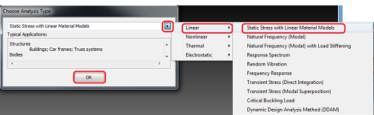

  3. If the analysis type is not already set to Static Stress with Linear Material Models, click the arrow, select Linear, and Static Stress with Linear Material Models. Then, click OK.
