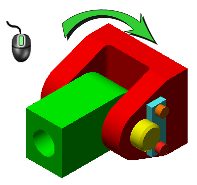

  1. To rotate the model, hold the middle mouse button, and move the mouse:

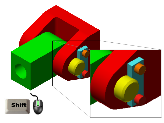

  2. To zoom the model, press Shift and the middle mouse button, and move the mouse:

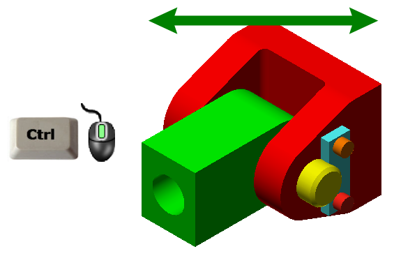

  3. To pan (move) the model, press Ctrl and the middle mouse button, and move the mouse:

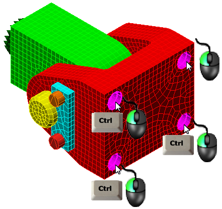

  4. When you select an item, any items that are already selected will be unselected. To select multiple items, hold Ctrl while left-clicking on them. When you have to select multiple items, it is good practice to select one item, and then hold Ctrl while you select the remaining items. This ensure that you first clear the selection list (to avoid including any incorrect items), and that you correctly select all the desired items.
