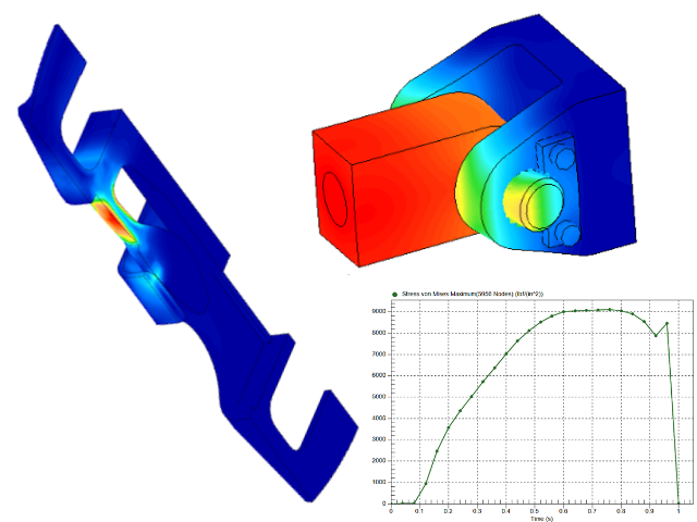

Step 2: Do a Quick Start Tutorial
There are two quick start tutorials—one linear static stress analysis and one mechanical event simulation (MES). Each is a typical example of using Simulation Mechanical. They both introduce similar concepts, but the MES example includes the additional setup needed to define how the nonlinear event proceeds over time. Choose the one that most interests you.
Quick Start Tutorials
Please consult this introductory page for a brief overview. General comments and recommended program settings are provided along with instructions for downloading the model datasets.
Linear Static Stress Analysis of a Pin Joint Assembly
Determine the stresses, displacement, and contact forces in a pin joint assembly due to a tensile force applied to the rod eye.
Mechanical Event Simulation of a Snap-Fit Clip Assembly
Determine and graph the stress, as a function of time, for a clip assembly as the two parts are pushed together.
