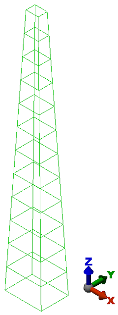

Next, we will copy and scale the base along the Z-axis to create the horizontal and vertical members.
Select
Lines command active, press Ctrl-A to select all four lines of the base.
Pattern
Move or Copy. The Move tab of the Move, Rotate, Scale or Copy dialog box appears.
Navigate
Orientation
Isometric View. The tower should display as shown in the following image.
