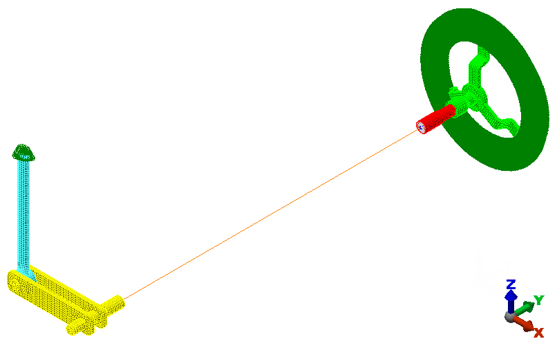

Click the Home icon ( ) that appears above the ViewCube when the cursor is in that area. The model is fit within the display area.
With the Selection Shape Point or Rectangle and Selection Select Surfaces commands active, click the annulus of the hand wheel, as shown below (highlighted in cyan).
Click Setup Loads Moment.
Type 200 in the Magnitude field
Select the Y radio button.
Click OK.
The model should display as shown in the following image.
