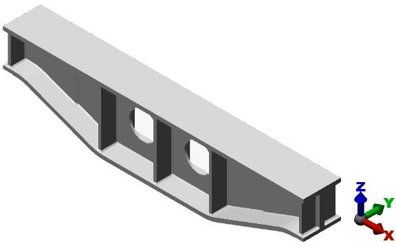

  4. Ensure that the analysis type is set to Linear Static Stress with Linear Material Models and click OK.
  5. Click No when prompted about using the default Simulation Mechanical color pallette instead of the CAD model colors.
  6. Click Yes when prompted about importing CAD part names. The model opens in the FEA Editor environment, as shown below.
    • Set the analysis type to Linear Static Stress with Linear Material Models.
    • Click the OK button. The model opens in the FEA Editor environment, as shown below.
