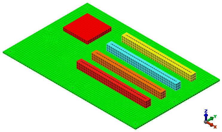

- Click OK. The model opens in the FEA Editor environment. as shown below.
