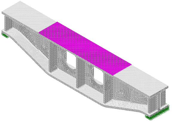

Apply the Surface Force
Click the
Home
icon that appears above and to the left of the ViewCube when the cursor is near it. The isometric view of the model is displayed.
Click the top, middle surface of the beam, as shown below.
Click
Setup
Loads
Force
Type
250000
in the
Magnitude
field.
Note:
Keep the default load
Direction
Normal
Click
OK
Next
