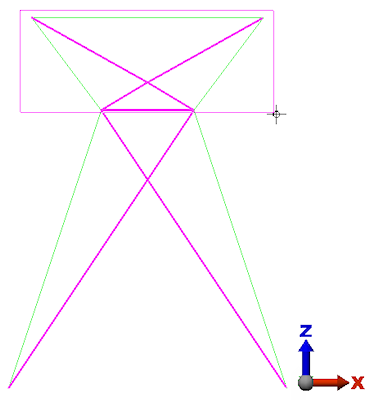

Shape
Point or Rectangle mode active, hold down the Ctrl key, click, and drag to draw a selection box that tightly encloses the short horizontal member and the X-brace above it, as shown below. Be careful not to include any elements from the lower X-brace.

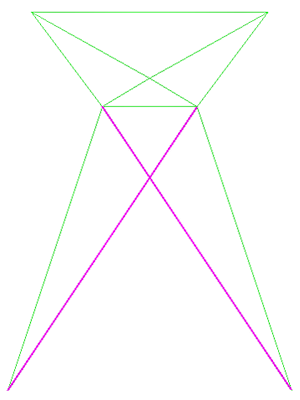

After releasing the mouse button, the upper members are deselected and only the lower X-brace remains selected, as shown below.
Invert I and J Nodes.

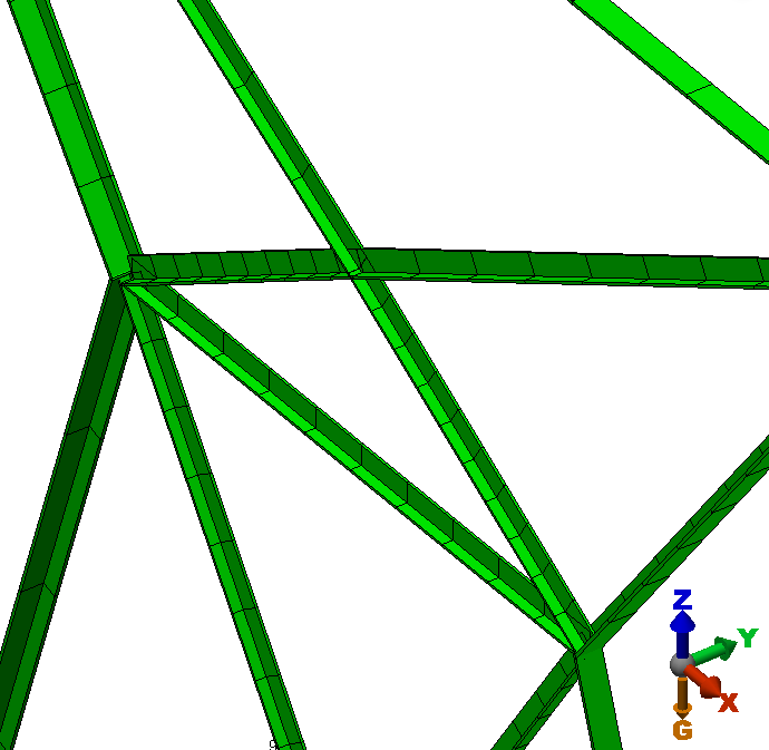

Shaded with Features to return to the default visual style for the Results environment.
