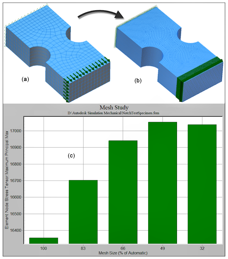

Run the mesh study
Press the Finish button on the wizard to proceed. When prompted to save your model, choose Yes. The wizard will show the progress of generating the new design scenario, meshing, performing the analysis, and so on. Each step of the process does all of the iterations before starting the next step. That is, all of the new design scenarios are created first (progress bar proceeds from 0 to 100%), then all of the new design scenarios are meshed (progress bar proceeds from 0 to 100%), then all of the new design scenarios are analyzed (progress bar proceeds from 0 to 100%), and so on.
View the results
When the mesh study completes, a graph of the result versus the mesh size will be shown. Right-click in the graph window to perform various graphing functions, such as customizing the layout, saving the graph to an image, and so on. (The graph behaves the same as the graphs in the Results environment. So, if you are familiar with customizing and exporting those graphs, the mesh study graphs are the same.)
Figure 1: Mesh Iterations and Results Graph
Legend: (a) - First Iteration, (b) - Last Iteration, (c) Results Graph
Also, the results of all iterations are saved in the model as new design scenarios. Open the model in Simulation Mechanical and load the appropriate design scenario to review the input and results.
