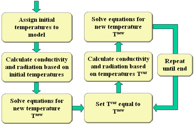

On each iteration of the steady-state solver, the temperature-dependent conduction coefficients and the radiation heat transfer rates are estimated based on the prior estimate of the nodal temperatures, (T i cur). On the first iteration, the initial temperatures are given by either the values applied to the nodes individually (right-click a node and select the Add: Temperature command) or globally (Default nodal temperature in the Options tab of the Analysis Parameters screen). When initial temperature values are specified for nodes in the FEA Editor environment, those values over-ride the default values. The model is then analyzed. The resulting temperatures (Ti new ) are compared to the prior estimate of the nodal temperatures. If the difference between the prior and resulting temperatures is acceptable, as defined below, then the analysis iterations stop. If the difference is not acceptable, then the thermal conductivity and radiation heat rates are recalculated based on the new assumed nodal temperature estimates and the problem is solved again. This process is shown in figure 1.
Figure 1: Nonlinear Solution Process
In reality, the temperatures used to calculate the conductivity or radiation on the next iteration (T cur )are calculated as [(1-A)(T i old )+(A)(T i new )] or as the equivalent [T i old +A(T i new -T i old )] where A is the relaxation parameter (defined in the Relaxation parameter field in the Advanced tab of the Analysis Parameters screen) and T i old is the temperature calculated on the previous iteration. An A value of 1 is normally recommended. The assumed temperatures for the next iteration are the resulting temperatures (T i new ) from the iteration just performed. Values between 0 and 1 are used when it is desired to update the temperatures T cur by a smaller amount to damp out possible overshoot oscillations. Since a value of 0 would cause the temperatures not to be updated, use a nonzero relaxation parameter. A relaxation parameter not equal to one is needed when the nodal temperatures cycle between successive iterations instead of converging smoothly.
The new assumed temperatures are used to update the conduction coefficients and recalculate the radiation equations and the process is repeated.

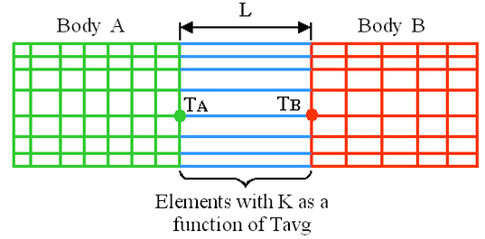

In some cases, body-to-body radiation can be emulated using temperature-dependent conduction as shown in the following figure:
Figure 2: Body to Body Radiation
The requirements for this approximation to be accurate are as follows:
  1. The view factor between the bodies must be close to 1.
  2. The heat flux out of the system is negligible; that is, there is no radiation to the environment.
  3. The surface area of each body is equal.
  4. The expected temperatures of the surfaces are known either from hand calculations, experimentation, or previous analysis (multiple iterations).
The heat exchanged between two bodies which see each other and nothing else can be written based on the surface resistance and space resistance of the bodies as
Where T A and T B are the temperatures of surfaces A and B (in absolute temperatures), ε A and ε B are the emissivities of surfaces A and B, and VF AB is the view factor between the two surfaces.
The heat flow due to conduction between the two bodies is
Since the heat flow due to radiation must equal the heat flow by conduction, equating the above two equations and expanding as follows
leads to the solution
using absolute temperatures.
One layer of elements is constructed in a new part between the two bodies. The material model is set to orthotropic so that the material properties are temperature dependent. The conductivity is calculated at estimated surface temperatures T A and T B (in absolute temperature) using the above equation. The calculated conductivity is entered in the material properties at a temperature of Taverage=0.5(T A +T B ) (in either absolute temperature or temperature, as set in the Units Definition dialog). Additional data points are entered by evaluating T average and K at other values of T A and T B . Be sure to include a range of temperatures T average in the material properties to that the calculated temperature is not outside of the range of material properties.
Note:
  • Use only one element across the span L for the body to body radiation approximation. A mesh in the direction L must not be used.
  • Different combinations of T A and T B can lead to different conductivities, K. The same temperature T average , the K to enter should be an average of all conductivities resulting for a given temperature T average .
