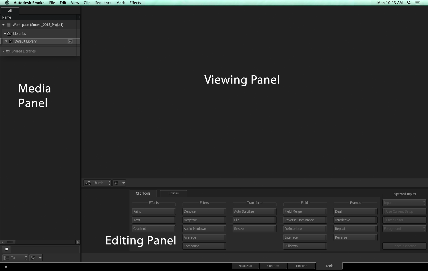

The workspace is where you accomplish all of your project tasks. The workspace consists of three main panels:
- The Media panel
- The Viewing panel
- The Editing panel
Each panel has its own menu bar with commands specific to the tasks you can perform in that space.
