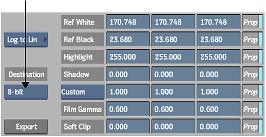

  1. Select an output bit-depth option from the Destination box in the LUT Editor.

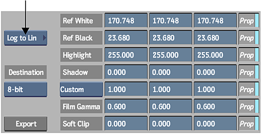

  2. Select an option from the LUT Type box.
    Select: To:
    Colour Transform Apply a colour transform based on the Academy/ASC colour transform XML format, as well as several other supported LUT and transform formats.
    PhotoMap Begin with a default curve for tone mapping.
    3D LUT Import a 3D LUT. Note that 3D LUTs are not available for floating-point values.
    1D LUT Import a 1D LUT. Note that some 1D LUTs are intended for integer values and others are intended for floating-point values.
    EXR Display Begin with a default curve for tone mapping.
    Gamma Begin with a default curve for modifying linear data.
    Lin to Log Begin with a default curve for converting linear or video data to logarithmic data.
    Log to Lin Begin with a default curve for converting logarithmic data to linear or video data.
