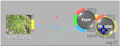

To connect nodes automatically with autolink:
  1. Use the Autolink feature by pressing Option and dragging a node to another node so their tabs touch.

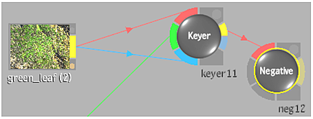

    Action: Press and hold Shift while dragging the Negative node to the Keyer node
    Result: The Keyer output is the front for the Negative node

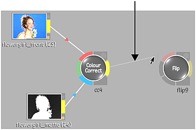

To connect nodes manually:
  1. Click the Result tab of a node whose result to be used and drag the cursor to one of the source tabs of the next node in the process tree.
    An arrowed line is drawn from the node to the source tab. For example, click the Result tab of the Colour Correct node and drag the cursor to the front tab of the Flip node to flip the result of the colour-corrected clip.
