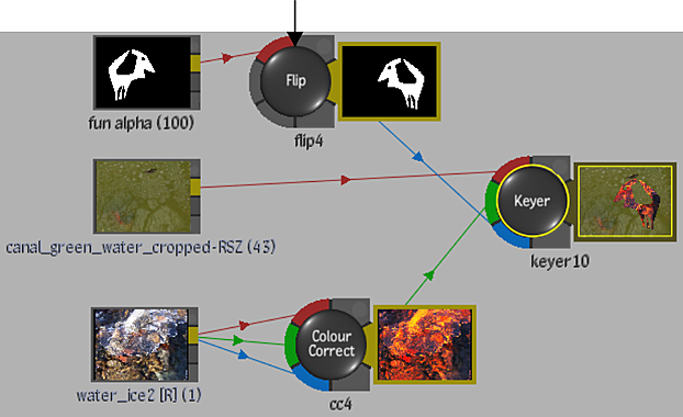

To bypass a node input:
  1. In the schematic, select the node whose input you want to bypass.
  2. Enable Bypass.
    The Bypass box becomes active.
  3. Select the clip that you want to pass as the input to the next node from the Bypass box.
    Note: The Flip node, which was selected in step 1 of this example, has input tabs for a front source. Therefore Front is the only option in the Bypass box.

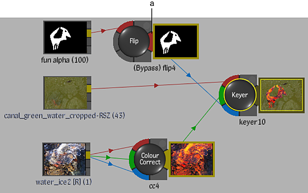

    The output tab of the bypass node changes colour. In the following example, the tab turns red indicating that the Front input is passed to the next node in the tree. As well “(Bypass)” is added to the node name.
    (a) Output tab of bypassed Front input
