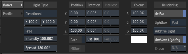

Basics Tab
Light Type box
Select the type of light to apply to the scene.
Light Type: Description: Example:
Point / Spot A point light radiates light uniformly in all directions. A spotlight radiates a cone of light centred along the spotlight direction. Use the Spread field to change the spread angle. A spread of 90° or less creates a spotlight.
Directional A directional light shines evenly in one direction only. The light icon in the scene displays an arrow showing the direction of the light. Use a directional light to simulate a very distant point light source (for example, the sun as viewed from the surface of the Earth).
Ambient An ambient light shines in two ways—some of the light shines evenly in all directions from the location of the light (similar to a point light), and some of the light shines evenly in all directions from all directions (as if emitted from the inner surface of an infinitely large sphere). Use the Shade field to set the percentage on ambient light applied.
Note: The ambient light type is not the same as the global Scene Ambient lighting available for the whole Action scene.
Rectangle Area A rectangle area light is similar to a point or spot light except that it produces a hotspot based on the shape of the rectangle. Use the area size fields to set the size of the rectangle.
Ellipse Area An ellipse area light is similar to a point or spot light light except that it produces a hotspot based on the shape of the ellipse. Use the area size fields to set the size of the ellipse
Different settings may appear directly below the Light Type box depending on the type selected.
Width field
Displays the width of an area or directional light. Editable.
Height field
Displays the height of an area or directional light. Editable.
Shade field
Displays the percentage of ambient light applied. Editable.
Light Mode box
Select Free to light the scene in the direction that you aim the light, or Target to aim the light at a target object in the scene based on a point of interest.
Light Intensity field
Displays the intensity of the selected light. Available in the Light menu Basics and Profile tabs. Editable.
Light Spread field
Displays the spread angle. A value of 90° or less creates a spotlight. Available in the Light menu Basics and Profile tabs. Editable
X Position field
Displays the position of the selected light along the X axis. Editable.
Y Position field
Displays the position of the selected light along the Y axis. Editable.
Z Position field
Displays the position of the selected light along the Z axis. Editable.
Path button
Enable to animate the position of the light using a spline drawn in the scene. Disable to animate the position of a light using explicit animation.
Motion Blur button
Enable to use a motion blur effect for the selected light (can only be used if the global Motion Blur is enabled in the Setup menu).
X Rotation field
Displays the rotation of the selected light along the X axis. Available when Free is selected in the Light Mode box. Editable.
Y Rotation field
Displays the rotation the selected light along the Y axis. Available when Free is selected in the Light Mode box. Editable.
Z Rotation field
Displays the rotation the selected light along the Z axis. Available when Free is selected in the Light Mode box. Editable.
Distance field
Displays the position of the light's focus. Available when Free is selected in the Light Mode box.
X Point of Interest field
Displays the position of the point of interest along the X axis. Available when Target is selected in the Light Mode box. Editable.
Y Point of Interest field
Displays the position of the point of interest along the Y axis. Available when Target is selected in the Light Mode box. Editable.
Z Point of Interest field
Displays the position of the point of interest along the Z axis. Available when Target is selected in the Light Mode box. Editable.
Roll field
Displays the amount of light roll. Available when Target is selected in the Light Mode box.
Red Light field
Displays the red value of the selected light. Editable.
Green Light field
Displays the green value of the selected light. Editable.
Blue Light field
Displays the blue value of the selected light. Editable.
Light colour pot
Displays the colour of the light source. Editable.
Active button
Enable to turn the selected light source on.
Scene Ambient button
Enable to have global ambient lighting in your Action scene. This same setting can be found in the Action Setup menu and the Light menu.
