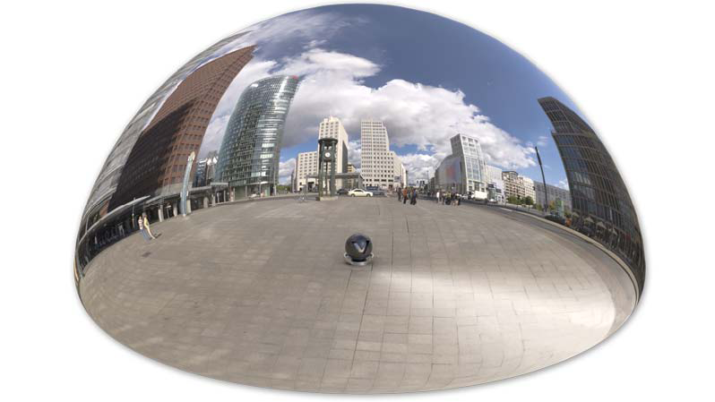

Sphere Environment
Environments add realistic reflections and light sources to the scene. Use Sphere Environments in Truelight Material. They deliver precomputed Image-Based Lighting (IBL) for Truelight Material they are assigned to. The lighting of a Truelight Material can be adjusted with the settings of the Sphere Environment. Each Sphere Environment can be assigned as an input node of each Truelight Material in the Material Editor (see General Truelight Material Settings » Common » Environment). The Sphere Environment is a single-sided shader in OpenGL rendering mode.
The Sphere environment gets its representation and lighting behavior from a texture file.
