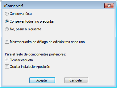

- In the Keep dialog box, select Keep this one.
Click OK.

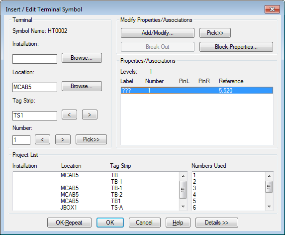

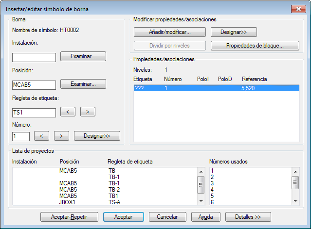

- In the Insert/Edit Terminal Symbol dialog box, Terminal section, specify:
Location:
MCAB5
Tag Strip:
TS1
Number:
1
- Click OK.
- In the Keep dialog box, select as indicated:
- Click OK.
