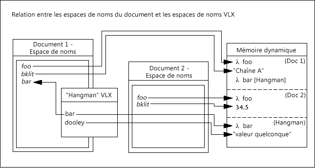

A VLX application can export function names to a document namespace to enable those functions to be accessed within the context of that document. The following diagram illustrates how this works:
The diagram shows an AutoCAD session containing two open drawing documents. A VLX application named “hangman” is loaded with respect to Document1 (for example, a user opened Document1 and then loaded the VLX application from the AutoCAD Command prompt). The hangman application established its own namespace and declared the bar function and the dooley variable in that namespace. The VLX exported the bar function to Document1's namespace. When a user invokes bar from Document1, bar runs in the application's namespace. The bar function is unknown to Document2, and neither document has access to the dooley variable (because the VLX did not export it). You can load another instance of the hangman VLX into Document2, but this instance will have its own namespace and its own copies of bar and dooley.
