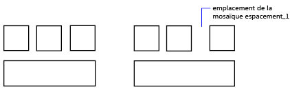

The spacer_1 tile, demonstrated in the following figure, is a spacer whose width and height both equal one. It is used for the smallest kind of spacer that will still be obvious to the user.
The spacer_1 tile is defined in the base.dcl file.
