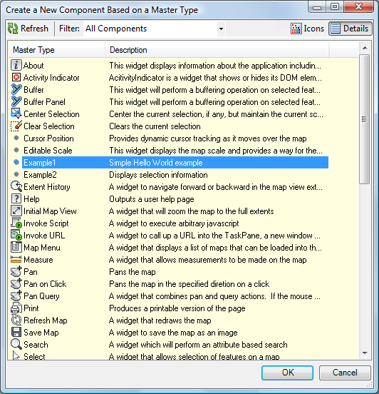

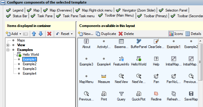

The widget information file defines a master widget type. Infrastructure Studio uses this type to create instances of the widget and add them to flexible web layouts. The sample flexible web layout already has this widget added to the menu. If you want to add a new instance to another location in the web layout, perform the following procedure:
  1. Select the tab for the container where you want to place the new component.
  2. In the Components Available in this Layout section, click New.
  3. The list of master widget types displays. Select the master type and click OK.
  4. This creates a new instance of the master type. Change any of the parameters for the widget, as required.
  5. Drag the widget to the list of items in the container to add it to the layout.
A single instance of a widget can be referenced in more than one place. The parameters for the widget are the same for every instance. For example, the widget for Example 1 could be added to the map context menu as well as the Examples menu. It would perform the same function regardless of where it was called.
